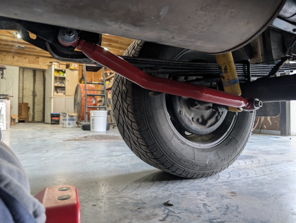

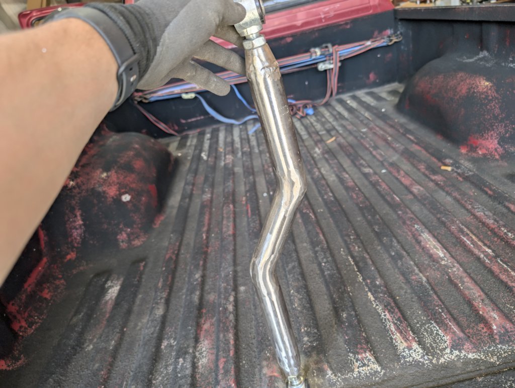

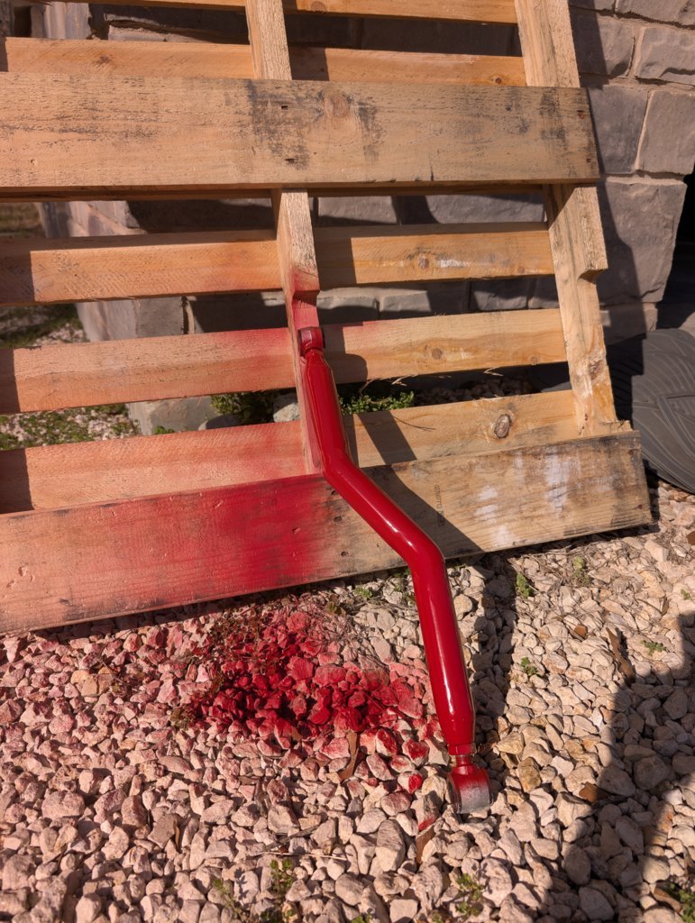

    Another minor update. I fixed the wheel hop!
    I made a weird looking traction bar loosely based off of this: https://www.customtacos.com/threads/axle-wrap-bye-bye.137140/
    I installed it at full droop and tightened everything once weight was on the rear-end. I also added back the 3 leaf add a leaf kit that i bought a few years ago as the stock spring were so pitiful. I put ~250lbs in the back and had way too much lean imo. I'm going camping this weekend as well so I wanted a bit more load capacity without squatting the truck lol.
    Looks a bit wonky but this is .250 wall 1 something inch tubing, something else will break before it bends lol
    coat of red paint (makes you faster)

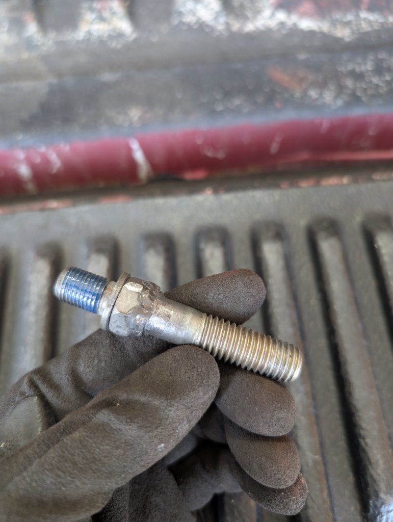

    I welded a stud to the shock bolt, I believe this will be a failure point, but at stock power I think it'll hold
    Here it is installed. A longer leaf eyelet bolt was used. I'll be replacing the hard plastic bushings in the rod ends with 95a TPU to allow more compliance but from the tests I did I still have full range of motion for a stock truck.

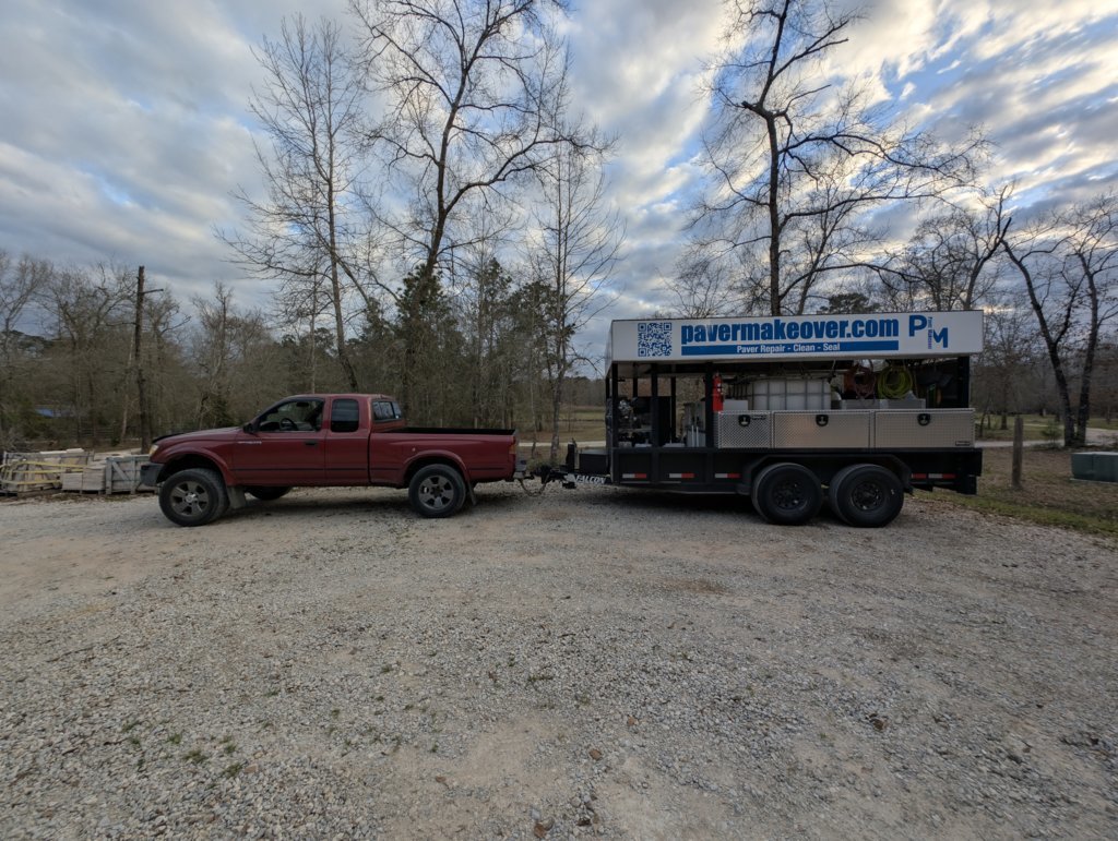

    This was my bind test. This trailer fully loaded with chems and water is around 12,000lbs. The water was only maybe 100lbs with 500lbs of motors and pumps and 450lbs of bleach plus a couple thousand for equipment and misc, I figure it probably weighs 8000-9000lbs in the picture with a pretty constant tongue weight of 1000-1200. It's normally towed by a '24 GMC 2500, but it worked well to stress the new suspension setup. (I only drove a few hundred feet, the Tacoma has no trailer brake controller and my rear frame section probably didn't love that much weight)
    Nothing broke in the short test and I can launch the truck on the converter and actually spin the tires instead of the truck doing its best impression of a paint can shaker.
    Torspd, unstpible and XPOTRPR like this.

    nice! could you possibly double shear that traction bar mount to the axle tube?
