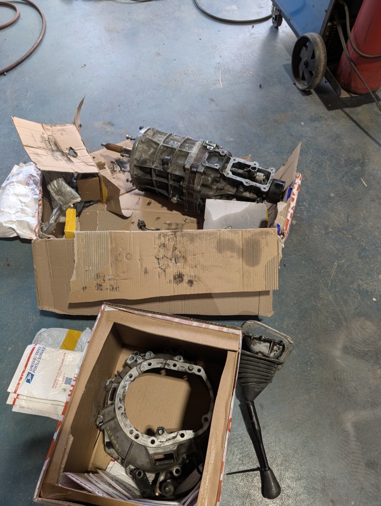

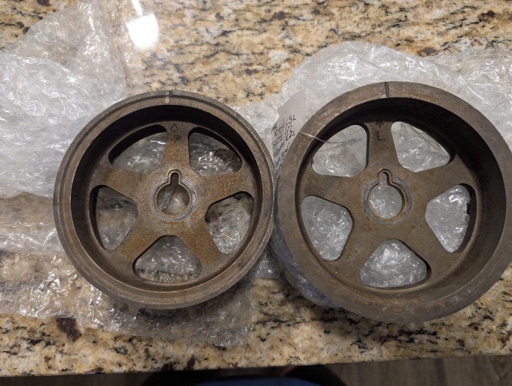

    Man these cam sprockets were really heavy for some reason...
    Oh wait
    Nvm, found em
    Yeah so I've decided to r150 swap the truck. I've been reading about it and it seems it can take pretty good abuse for its price point. I paid $999 for the above unit from eBay. 188k miles and it came from a 99 prerunner. For that price I got the trans, bell housing, slave, master, throw out bearing, clutch fork and shifter. I'll probably rebuild it but I'm happy. I still need about $500 in additional parts plus or minus a couple hundred depending on the clutch I go with. Kinda bummed lce doesn't sell the ultralight flywheel anymore though.
    The stuff I had been searching on old forum posts had supra guys putting 450-500 wheel down with these (or one of its variants) and a guy with a turbo 2j 4Runner (iirc) was putting down like 670 wheel on drag slicks, launching it trying to break it. :D

    Very curious how you went about changing the cam timing. When you moved the cam gears 1 tooth on the belt, did you then realign the exhaust cam with the intake? Or did you just move 1 tooth on the intake side? I would think that would serve as retarding the intake cam and advancing the exhaust(I could be backwards....). If I remember my counting correctly, 1 tooth on the helical gear in the head translates to 9°.

    Well I didn't mess with the internal timing between the two cams. I would think the exhaust cam would be ground in reverse of a normal exhaust cam since it's slave driven. And 7.5 degrees was way too much both in practice and after doing some research. I have thought about messing with the timing between the two cams but if I understand correctly that would change the lobe separation angle on a setup like this no? I really don't know what I'm doing yet lol.

    I retarded the intake cam one tooth which was worth 7.5 degrees I think. But I think you're right about the exhaust cam having been advanced. If I understand correctly, since the exhaust cam spins the opposite direction it would've been advanced and I think that's why the truck won't rev very high at all. If I were to advance the intake cam I believe that would retard to exhaust an equal amount. If having advanced the intake I then moved the internal exhaust gear one tooth away from the intake cam that would move it 9 degrees back towards stock alignment. Basically Intake 7.5 degrees advanced, exhaust 7.5 degrees retarded, moving the exhaust cam one tooth away from intake would give intake 7.5 advanced, exhaust 1.5 degrees advanced. Assuming one tooth on the sprocket is 7.5 degrees and one tooth on the internal gears is 9 degrees (I counted last night and they do have 40 teeth).
    Some possible combos with all stock parts could be:
    Intake 7.5 advanced, exhaust 7.5 retarded
    Intake 7.5 retarded, exhaust 7.5 advanced (what I currently suspect I've done)
    Intake 7.5 advanced, exhaust 1.5 advanced
    Intake 7.5 advanced, exhaust 16.5 advanced
    Intake 7.5 retarded, exhaust 1.5 retarded
    Intake 7.5 retarded, exhaust 16.5 retarded
    Intake 0, exhaust retarded 9 degrees
    Intake 0, exhaust advanced 9 degrees
    I'd wager intake 7.5 retarded, exhaust 1.5 retarded would be the sweet spot. And when I say "exhaust advanced/retarded" I mean relative to the intake cam gear.
    I currently have the truck apart so I think I'll retard the intake a tooth and move the exhaust cam back one gear tooth the get the 7.5/1.5 retarded hypothetical.

    Alright so I played around with the cam timing some more.
    So far I have tried these combos:
    stock timing: engine runs and revs fine but falls off up top
    Intake 7.5 retarded, exhaust 7.5 advanced (call this one an oversight): engine ran fine but wouldn't rev past 3500rpm. Power was weird too.
    Intake 7.5 retarded, exhaust 1.5 retarded: this is the best combo so far. Engine keeps pulling to at least 6200rpm but the gearing is suboptimal I think. 2nd gear will get you to 85mph with 4.10 rear gears and 3rd will go faster than you reasonably should in something brick shaped.
    I'm sticking with the 7.5/1.5 retarded setup. Custom cam gears would make this far more tunable but for all stock components it's pretty good I'd say. The intake is quieter than stock, and much much quieter that the 7.5 retarded intake, 7.5 advanced exhaust thing I did.

    Ive been wondering if 2j cam gears have the right offset to work on a 5vz. They're the same tooth count at least.
