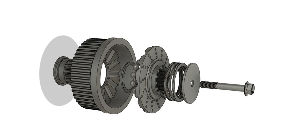

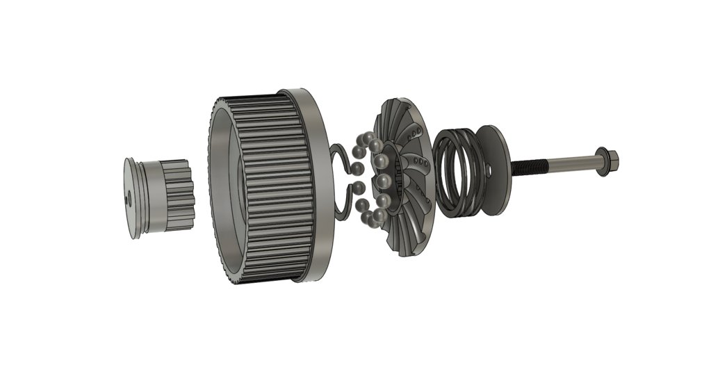

    So these are some rough models to get this idea out of my head and on paper (or a computer screen). There a several things I wanna change here, but the rough idea is present.

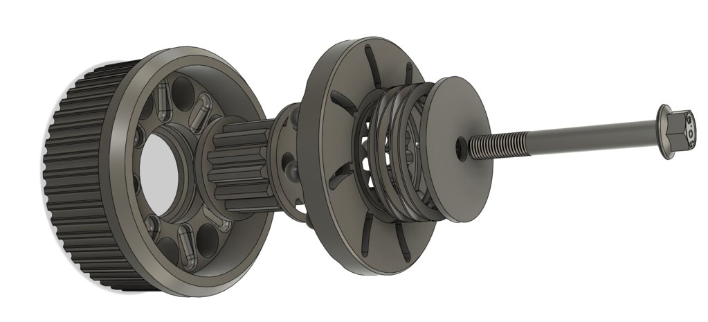

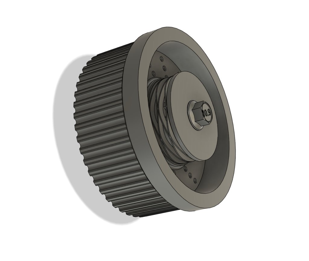

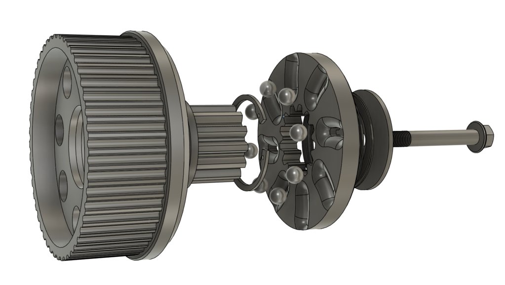

    Alright so after about 8 hours of modelling I have this. This will be my first prototype (3d printed to verify amount of phase change and general fit relative to the part itself and the cam) I modelled it for 18* advanced with 15* advanced in mind.
    this model has accurate geometry and clearance for being made of steel. Tolerances will be increased for the 3d printed part, likely to be made of PETG. Also I wont be testing the 3d printed part on the truck, that probably wouldn't end or work well.
    This version lacks any oil seals which I plan to incorporate later to have it be self lubricating with some variety of oil.
    The idea is that it will advance the intake cam from -7.5* to +7.5* and retard the exhaust cam from +7.5* to -7.5*. In theory I would set the intake cam 7.5* retarded relative to factory timing (one belt tooth retarded) and then somewhere near my 6800 redline (maybe 6500?) end up with the exact opposite for better top end breathing.
    The splined section is directly coupled to the intake cam via a longer than factory bolt and the stock dowel pin. The outer sprocket/ramp section will be retained on the splined section with a C-clip facing away from the engine and a shoulder facing toward the engine to prevent any axial movement. The outer sprocket section will be coupled to the splined section via 13 10mm ball bearings and the phase plate (plate with the curves) held in a neutral position by a wave type spring. The spring will be retained by a big washer thing that im not 100% set on and the spring will be preloaded by the cam bolt once tightened to factory spec.
    Basically at idle everything will spin as one. Once RPM increases the ball bearings will overcome the spring pressure and move outward due to the ramped nature of the sprocket/ramp plate. As they move outward they will force the phase plate clockwise a maximum of 18*, thereby advancing the intake cam and retarding the exhaust cam. The splined section of the phase plate will phase the cam and the splined shaft will allow forward axial movement for the ball bearings to migrate outwards with RPM.
    I have absolutely no idea if this will work. On paper it certainly can work but I have no clue what the spring rate should be nor the ramp angle. Currently the ramp angle is 8* which should be pretty mild from what I've researched on mechanisms of this type. The spring in the model is 65lbs which may, or may not be, too much, but should be in the ballpark of the forces generated here.
    Ideally I will end up with a 5VZ with mechanical VVT, perhaps the first ever, if not with VVT then certainly with purely mechanically VVT

    And a what it looks like fully assembled as a 3d model (OEM cam gear is about 45mm thick vs this at 62mm thick currently, 17mm difference) (measured from bolt head to end of sprocket)Screenshot 2025-04-20 205439.png

    Thats a ton of really really cool modeling, how are you planning to get stuff made?
    Reminds me of SxS CVT design, you should be able to refer to those spring/ramp/weight calculations to make sure you will at least have action in you working RPM range if not actually at a target RPM.
    To my knowledge this type of mechanism would probably be progressive over a fairly "large" RPM range vs modern designs capable of executing a large advance at a specific RPM.
    Alfa Romeo has a horrendously annoying Mechanical VVT from the... 70s that my Dad loves to tinker with, but damn those cars need an overhaul every 6k miles.
    They have an imbalanced but possibly more tuneable centrifugal advance mechanism.

    Yeah the working range should be fairly large so I'll probably end up targeting a balance, but any advance done to the intake retards the exhaust since they are counter rotating. If I start with the intake retarded then the exhaust is advanced and I already know that that combo works pretty well until 3000-3500 where it literally stops the engine from revving. If I can tune it to be around 0° at 3000 then advance from there I should be in good shape I think.
    As for manufacturing I am looking at places like PCBway or jlc PCB. They do cnc stuff but I haven't uploaded anything to them to check price yet.
    I found that Alfa Romeo stuff in my research but honestly I glanced at the design and kinda forgot about it. I will look into it more though. As far as tuning goes I have a few options for ball bearings like tungsten, titanium and nickel and also the spring itself and if need be the phase plate as well, so I should have decent head room to tune I think.
