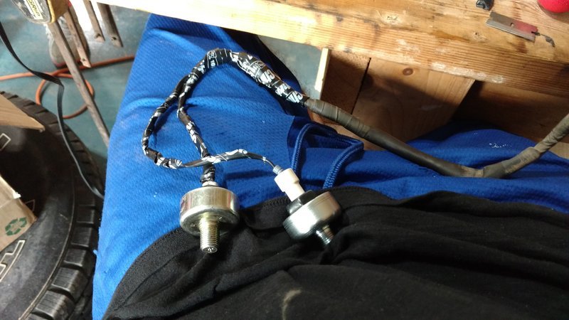

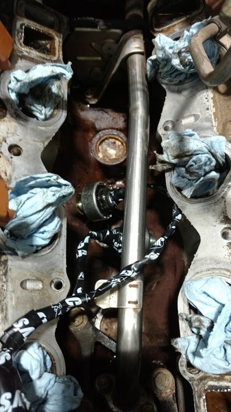

    Yeah I rigged my old one up and adapted it to the new sensor, removing the old brittle connector
    new extension harness I made
    How it looks under the tape
    I had to remove the stock chevy plastic connecter to properly fit and tighten the sensor and push on the connector. hope all goes well

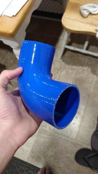

    So the build is delayed temporarily. I ordered 6 2.5 inch 90 degree bends off ebay which arrived as 2.25 inner diameter bends, the dude sellin em was measuring the advertised diameter using the OD.
    In case you didn't know, you measure couplers of any kind by inner diameter as nothing ever goes around the outside of them, but rather the inside. So I sent him a return request and offered to exchange the for actual 2.5" couplers. Oh and on top of that he sent me three 90's and three 45's when I specifically ordered six 90's. Welp that's why six 90's were $47 off ebay but $101 on Amazon...

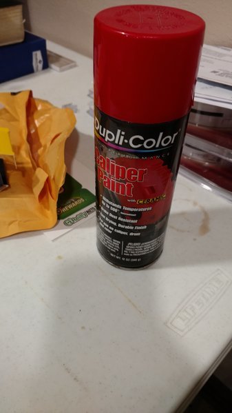

    Got me a part. 2.5-2.75" 90 degree
    And caliper paint for a red turbo.IMG_20160821_190234798.jpg IMG_20160821_190238038.jpg

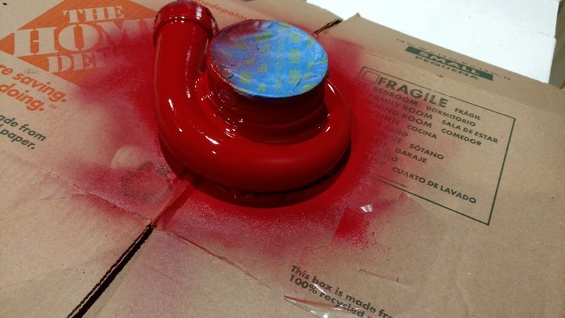

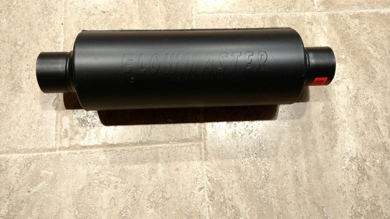

    Flowmaster Pro series muffler
    Painted the turbo red

    Never heard a pro series or hushpower on the 3.4 yet.

    Me either ;)

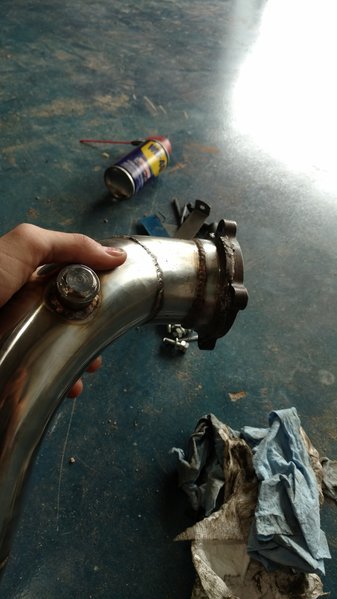

    Nice red turbo

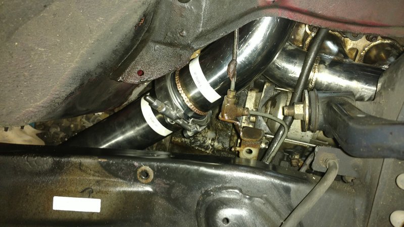

    Tac'd the exhaust up.
    how it sits with the 4-bolt welded to the v-band

    Damn, that's sexy. Makes sure your oil feed and oil drain are as close to vertical as possible before installing though.
  17. Aug 24, 2016 at 7:13 PM
    #257
    Brice
    Brice [OP] Turbo Member
    May 28, 2015
    #156265
    2,304
    Brice
    Texas
    1999 Tacoma PreRunner V6 SR5
    Wastegate assisted turbo delete
    Welp I got them as close as possible...well see :D
  18. Aug 24, 2016 at 7:18 PM
    #258
    StAndrew
    StAndrew Wait for it...
    Feb 8, 2010
    #30950
    8,410
    Hampton Roads, Va
    SR5 4x4TRD
    Intake, exhaust, lift. Typical stuff.
    I grinded mine down a bit to get it clocked right. If you don't get it clocked right, oil might leak into your turbo and pool there. Not good to gumb up your intake.

    Brice
    May 28, 2015
    #156265
    2,304
    Brice
    Texas
    Grinded what down exactly?
  20. Aug 24, 2016 at 8:01 PM
    #260
    StAndrew
    Feb 8, 2010
    #30950
    8,410
    Hampton Roads, Va
    SR5 4x4TRD
    My issue was the drain flange. I ground that down. I tried not to touch the turbo housing. I think I flattened a bolt as well.
