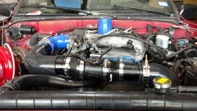

    Nope throttle and it dies

    You probably installed the MAF tube backwards and now your MAF is backwards? It really sounds like a MAF issue :notsure:

    Duuude that's probably the issue thanks so much!

    Take a pic and post here. I'll be able to tell real quick.

  6. Aug 26, 2016 at 5:48 PM

    looks like it is

    Ah, you didnt use a CX kit, but yeah, looks like MAF is backwards. DOH!
    Also, those clamps have to be SUPER tight. Try using hair spray on the inside of the silicon before installing to insure a good seal. Mine were all leaking.

    I'll have to fix my MAF when get home :D
    I'm only running 4psi right now so I may be ok, but yeah I'm gonna tighten them. Get that hair spray tip from Jafro?

    My shit was leaking at idle. IE, vacuum leak. If I ever boosted they'd have blown off.

    Yeah makes sense, alot of the pipes I cut also don't have bead rolled edges ( as I had to cut them off). I'll have to pick up some hair spray
