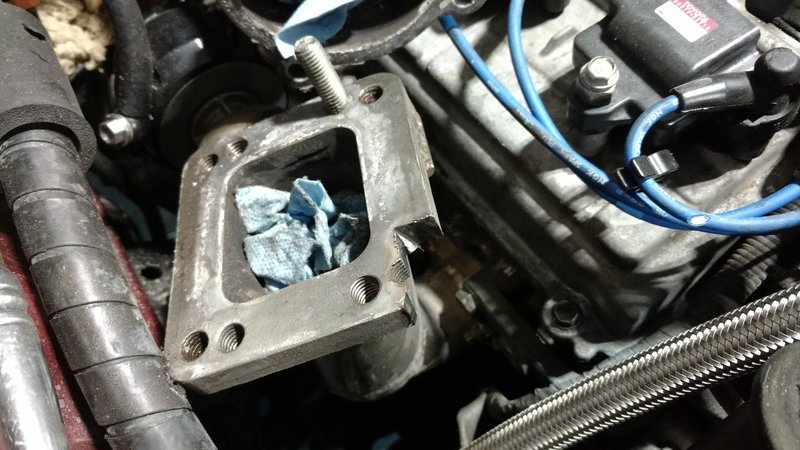

    2. I'm gonna have to grind some stuff for the turbo to be clocked correctly (left a james bond style exit on my way back home) like @StAndrew had suggested

    Oh and Andrew, could you send me a picture of what exactly you ground down? Its alright if yah cant.

    Unfortunately I can't get a pic without taking the turbo of. Just start clocking it until something hits. Examine it and stupid test it: "can I grind this and how much?"

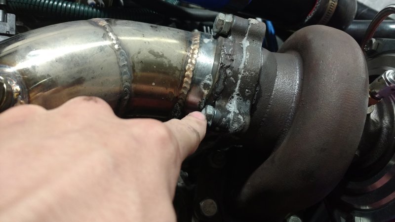

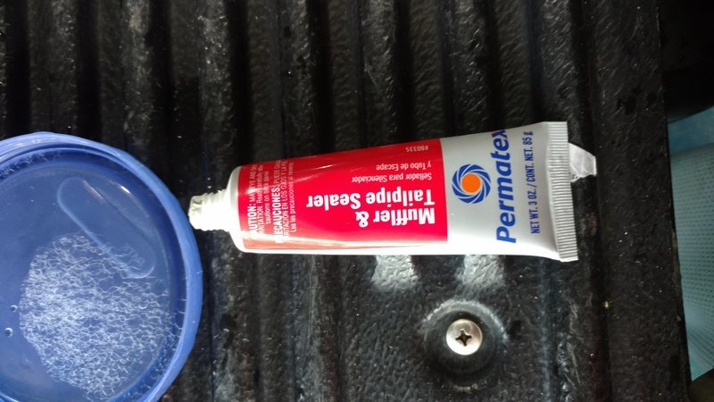

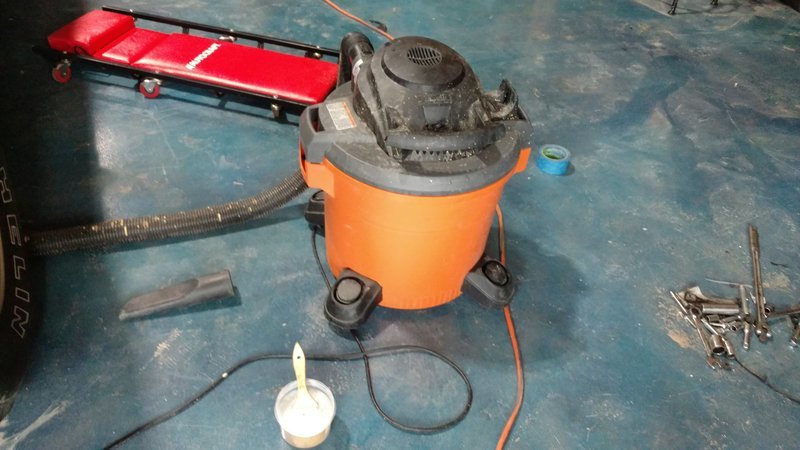

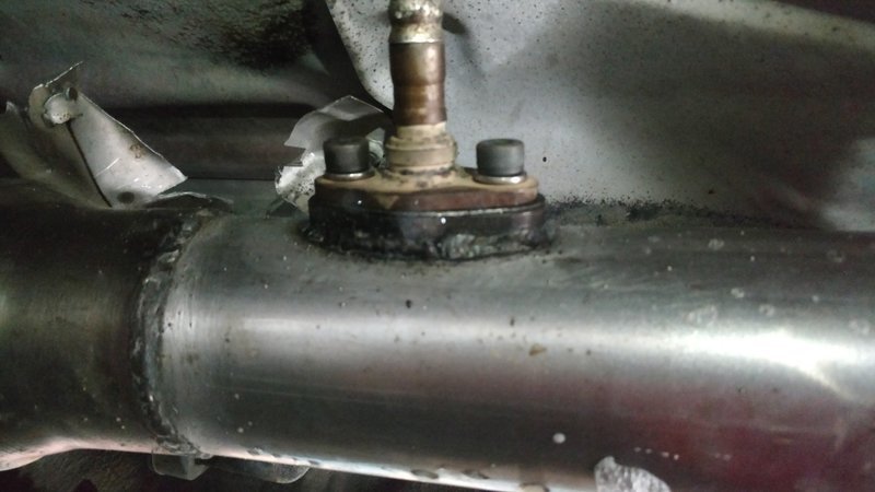

    How to find exhaust leaks
    Supplies:
    • A shop vac (or any vacuum that can blow)
    • A soapy solution (dish soap and water works well)
    • A sealant (muffler and tailpipe sealer off Amazon is what is used here)
    • A paint brush (a disposable works nicely)
    • And finally Tape.
    1. Set your vacuum of choice to blow
    2. Tape vacuum outlet to tailpipe (exhaust must be cold of course)
    3. prepare your soapy solution.
    4. Switch er' on!
    5. Now go about the suspect area's and "paint" over the exhaust with your solution. This should cause bubbles, those are your leaks.
    6. Now take your sealant and patch the leaking area, you may want to replace a gasket or even weld the leak if it is a large one.
    In my case I had a leaky o2 sensor gasket. My downpipe also had a slight leak. The were both fixed with the use of some exhaust sealant. I must thank @StAndrew for introducing me to this stuff. It works great!
    Shop Vac and soapy water.
    Leaky downpipe weld. I need to weld this from the inside of the pipe, by due to lack of time and the nature of the leak, I'll get away with pasting sealant over it.
    And finally, the sealant to fix it all.
    I'll add more pictures to this soon, but for now I had nothing to do so I posted what I had. :D
