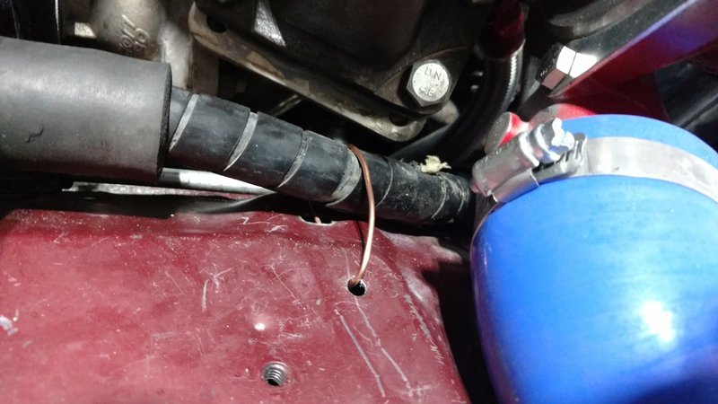

    For my A/C lines I just tied them to the inner fender, Eventually I'll get a turbo blanket but for now some Rockwool will do. IN other news... The knock sensors are still workin! (as far as I know) I'd say the chevy SU1075 is a valid replacement. No codes a'tall. For some reason when I let off the gas the truck will die every once in awhile... Its usually when I'm deceling from a high speed or just coming off boost, as long as the throttle doesn't close completely after boost or high speed then everything is just fine. Overall I'd say Im done with my install for now. Eventually an AEM, injectors and Meth are in order but until funds for that arise I'm done :D

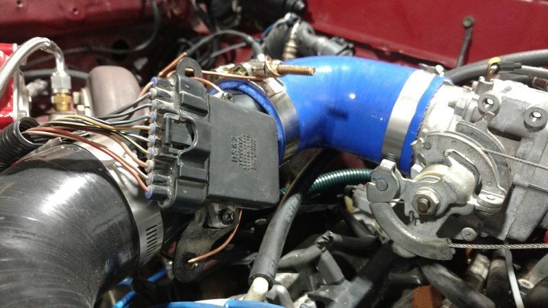

    Haha that sounds fun. Lemme know if that happens. I had to remove that check valve as it was preventing some sort of venting and was causing my valve covers to seep oil quite a bit, took it off and no problems.

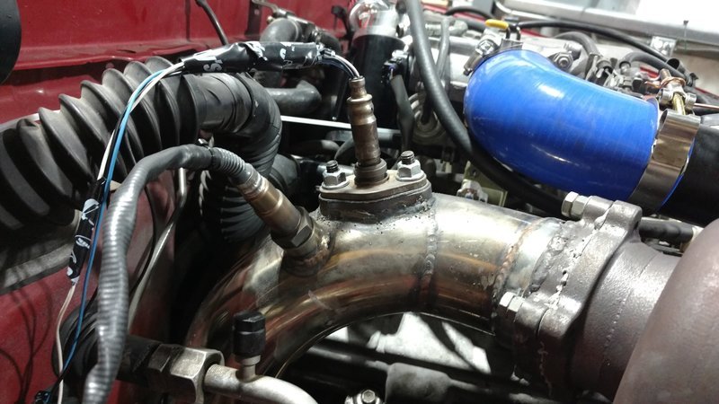

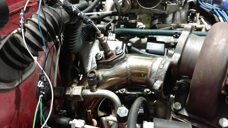

    Loy performance Igniter retainer. -$50 (quality stuff) not really lol
    Loy performance A/C retainer -$35
    Relocated the o2 sensor for AFR's I'm idling between 14.6 to 15.2 which is far better than before. I won't be able to get it super steady till the AEM.

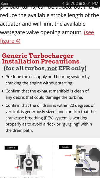

    The heat addressed by the article is the heat soak effect that occurs after engine shut down. All the heat from the header and down pipe go to the turbo and center housing after shut down because it is so much cooler. The amount of heat the center housing sees after shut down is the highest amount it will see ever which is why it is so important to have your angle right and a proper coolant siphon in effect, at least according to the article.

    No the one on the fresh air intake for the drivers side cover, which I will now abbreviated as FAI lol

    Nice to see another confirmation of the o2 relocation working out. It's only an issue on truck that have a bank 1 wideband. (99-04 5vz with automatics) You narrowband guys, consider yourself lucky. My truck is still goofy sometimes (throw p1133 sensor switching code) due to lack of heat/flow but mostly it's acceptable. It was nearly undriveable before o2 relocation.
    Also I keep the totally stock PCV system intact (which you really should keep functional). I simply vent the rear (driver) breather. Not even a filter, not that it wouldn't be a good idea. The 5vz doesn't really make any appreciable amount of blowby in boost. With 3 turbo trucks now, I've never wiped any oil off the firewall because of it. Part of that is due to the PCV system being functional and keeping the oil rings sealed better, among many other benefits of a functional PCV system. Even running 14lb boost, I never even used a check valve on the IAC or brake booster. What can I say, I like to live on the edge...

    Looking at the internal construction of the bearings and cartridge, you can see that how the oil will pool of the angle is too far from 0°. The second portion is then the drain path and size. Larger is better. Then there is PCV back pressure, as noted in the picture.

    I think that FAI port having a check valve would cause "gurgling" as they said which would also cause pooling? Regardless, after removing that check valve I'm not seeping oil anymore, and not blowing it all over the place. Thanks for posting this.
