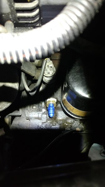

    Oh an also where are you guys plumbing your oil feed for the turbo? I used the 4 way adapter provided by CX into what I think is the oil pressure sensor off the block. The sensor has a single wire going to it and is on the front, bottom portion of the block on the driver side, just forward of the oil filter for reference

    Right below the Oil sender is a hex bolt that is pressurized oil, and it's what I used.

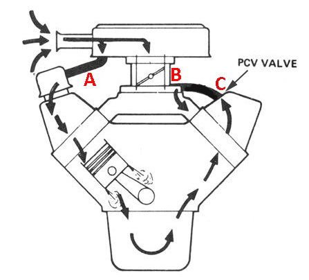

    Its supposed to flow like this:
    Otherwise you don't get rid of all the hot moist air in your crank and when you shut off your engine, the water condenses in your crank case as the engine cools. There needs to be a one way flow of clean air and vent of oily air. Its not just a system to "vent" the pressure but also introduce clean air into your crank case.
