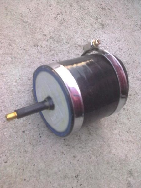

    At one point I fitted a compressor into the s/c inlet and pumped 15 psi and found a few leaks. How's your actuator?

    My actuator works but I actual had a issue with it after I got the sc rebuilt. Did you make the leak tester??

    Didn't make anything special just a few fittings to get the compressor hose quick fitting to a big hose clamp over the TB. Then I just sprayed soapy water and listened for sounds. My actuator did have a leak and I had a few little t fittings leaking I needed to clamp.

    Can you spray the plunger with soapy water?

    Of the actuator? I don't see why not. I sprayed pretty much everything. Yeah that's basically what I made.

    Do you remember what size rubber you used to clamp over the throttle body? 3"?

    It would have to be 2.75" ID tubing.

    You think 3" pic cap and rubber connector would work clamped down?

    Im betting solidly on no since you'd have to clamp about a 1/4 inch of material.

    Off the top of my head it was a 3" just clamped the shit out of it. I was having issues at like 30 psi with it blowing off but at 15-20 it was fine.
