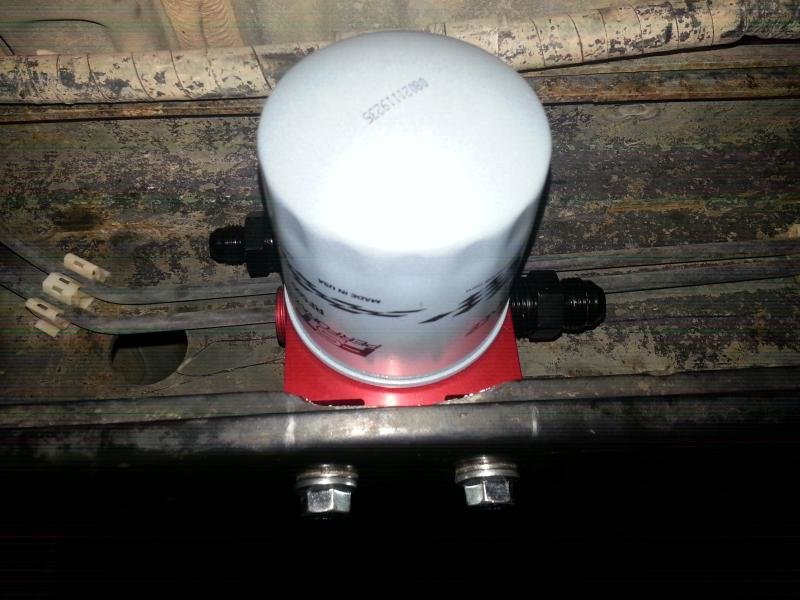

    Intake, exhaust, lift. Typical stuff.
    Silly C-channel frames...

    cross brace will solve that problem. Silly spaghetti noodle stock frame :devil:

    Did you upgrade you fuel line diameter as well?

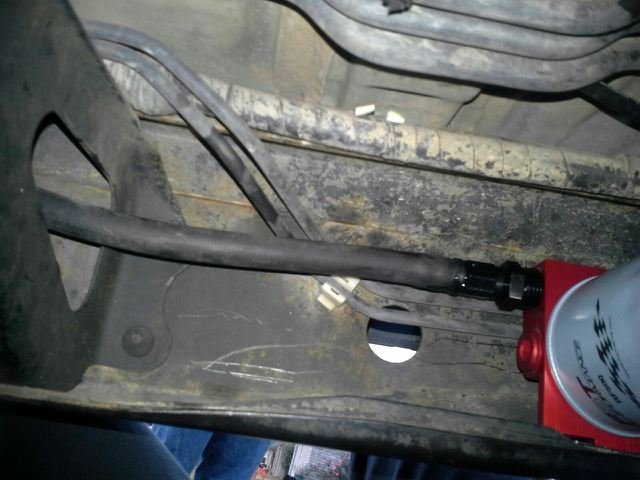

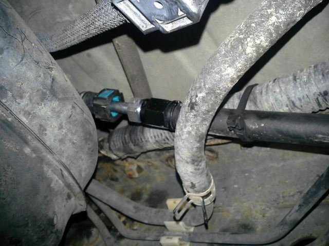

    5/16" adapter to -6AN into filter assembly. Then -8AN to and through fuel rail. -6AN out of the regulator.

    Wouldn't have been as easy to mount the filter on a boxed-section frame, which typically also have thinner walls...
