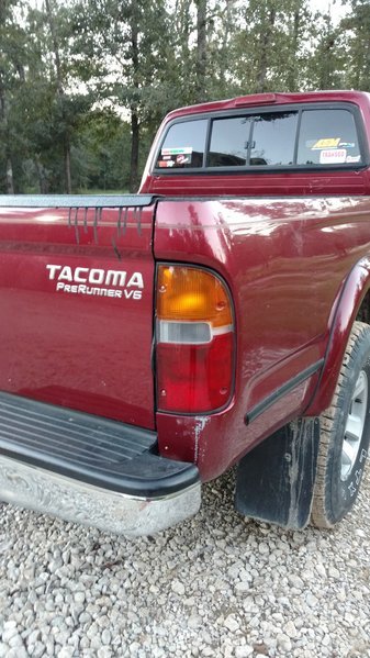

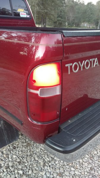

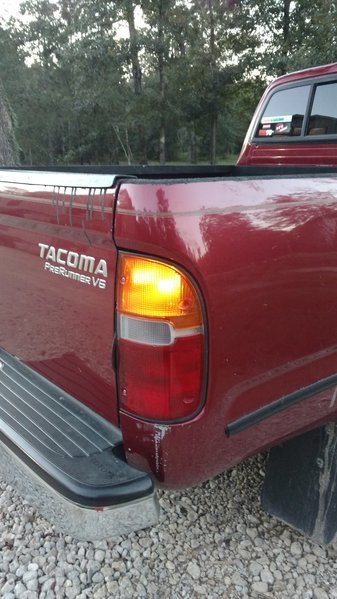

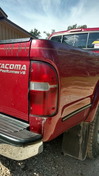

    I did a thing
    original
    after
    original lit up
    New tinted lit up
    IMO the red tint matches much better than the orange, I got this idea off a guy waaaaaaaaaaaaaaaaaaaaaaaaaaaaaaay back in the for sale thread for 1st gens
