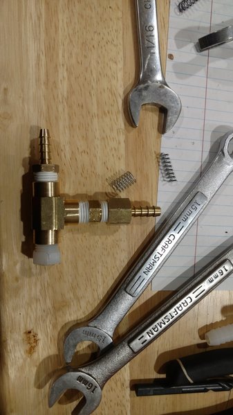

    Manual boost controller done. Kinda fudged it a bit but it should work fine. Next is a pressure switch. This is all for temporary btw.IMG_20161004_203344817.jpg

    Is there a downside to pre IC wastegate?

    Seems like u wont be gettin true spring rating boost at the manifold. And i would assume higher temps on the wg diaphragm may lead to shorter life possibly

    Less boost pressure unless you have a boost controller.
    Eh I doubt it, unless you have a cheapo eBay one, since the precision turbo WG is ment for much more than I'll ever use it for

    With a controller it doesn't really matter where you run the vacuum from, you can adjust get to get the proper/desired boost. The reason you would want to reference or run the vacuum directly from the turbo is so that the WG reacts quicker/without a delay as boost builds in the turbo which will prevent you from overboosting at the turbo. Again, this is only relevant if you are pushing your turbo to its max.
    How does this work? If its a valve, that's going to be hard to control the air flow, no?

    Its a ball and spring valve that I can adjust via a screw, just like a manual boost controller :D Essentially the boost has to push a ball into a spring which then allows flow to the wastegate, opening it.
