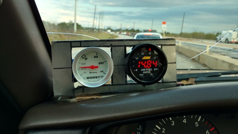

    Retro gauge holder. Ugly as sin, but still cool, IMO. :thumbsup:

    I am even envious of your AFR gauge. Sigh.

    Why's that? Lol

    You have their newest gauge which is low profile, displays in the hundredths, and uses the newer LSU 4.9 sensor.

    Oh yeah. Wanna hear my expert theory and reasoning behind buying this one in particular? It was the cheapest lol :D
    Cheapness aside it was super easy to setup and required no calibration, however I must say its really particular about what ground it sees, gotta be a really good one.
