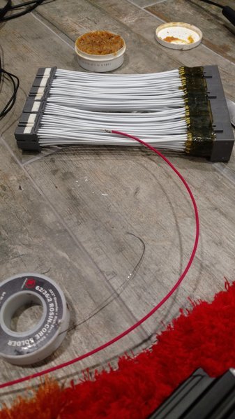

    Im about to wire the Ext harness so wish me luck, Im going off of @vasinvictors wiring layout :D

    Wastegate assisted turbo delete
    I was supposed to send the above message like 10 minutes ago, Oh well.
    One wire down :cool: a bunch to go.

    When I intercept these injector wires I wire the OUT signal to the truck's harness and the IN signal to the ECU? Is that right?

    You should absolutely double check all the wires.
    http://www.well.com/user/mosk/images/Early_Tacoma_ECUs_v1.pdf
    In connections are from the sensor to the AEM, out are from the AEM to the ecu. It sort of flips with the injector connections but if you follow the logic that the original signal is intercepted by the AEM it still makes sense, the injector signal from the ecu is intercepted before it reaches the injector.
    Also, not sure if you tracked down the guide on this forum but there are some shenanigans with a couple of resistors. I installed them exactly as depicted and ended up removing the one on the cam/crank signals. It varies truck by truck. My symptoms were crazy miss fires over 2500 rpm. Removed it and everything was good.

    Well Im looking at the pinout for a 4x4 99 5vz ecu and E8 pins 10 though 5 are the injector signals...but im not a 4x4? So what does this change? Do I follow this?

    Not sure but I would think it would be the same :notsure:

    Can't find AF1 for the oxygen sensor on the 99 5vz auto pinout, I can however find OX1 which I assume is the same as AF1. There is also OX2 which I assume is the tattle oxygen sensor in the back, OX1 standing for the primary and OX2 standing for the secondary tattle one...not sure though
    Also cant find G2, but I think G+ is the same thing...not sure

    Yeah G+ and OX1 are what I used.

    @Clay_916 Hey I cant find E01 for PWR GND what did you use? If you don't mind :D

    I can't recall the grounds but I know I used a different wire for all of them.

    Does it matter where its grounded to as long as its a ground? Id assume no...

    I also operated under that assumption and everything seems ok thus far.
