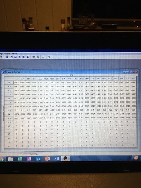

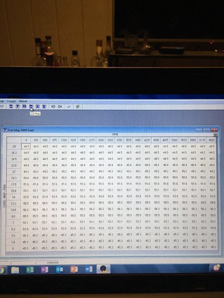

    I did take the truck out for a drive today, I noticed a couple of things.
    At idle and in gear it will stall out and die sometimes, and does it more frequently in reverse.
    At anything above 2500 rpm or so it bucks super hard then picks back up, the feeling is similar to if it was chained to a tree the all the slack in the chain was out.
    And the idle AFR is super crazy at around 13.8 to 15.5 soooo I guess I'll have to look into that, I did notice however that changing the O2 values had no effect on things really....

    I think it's my O2 sensor in some fashion? Also I've had these plugs pre AEM and I'm still at 5psi so I don't think they're causing problems yet... Maybe I actually have a narrow band and don't know it? Everything says I don't but idk...
    And I had also set up my timing map for -1 every psi of boost, Im pretty sure its my o2, or like you said the cam signal is still dirty... And the resistor bridges between the cam signal not the crank
    Also what did you guys do for the MAF? I cant seem to get open loop idle into stoich its super rich, but then closed loop kicks in and it fluctuates between 12.0-15.0 any ideas??
    As of right now nothing has worked and I'm out of ideas. (been screwing with this all day)

    I'm guessing your fuel map is too rich for your fuel trims to correct. You need to use a scanner and zero your trims. The resistor bridges the in bound cam signals but is also tied to the crank signal. Also check the pins on the harness, they're known to pop out. I didn't use any MAF skewing.
    What does your fuel map look like? O2 offsets don't change afrs at all?

    What values are in your MAF table?
    Also Ive removed 55% fuel...
    And I checked the harness, no loose pins :notsure:
