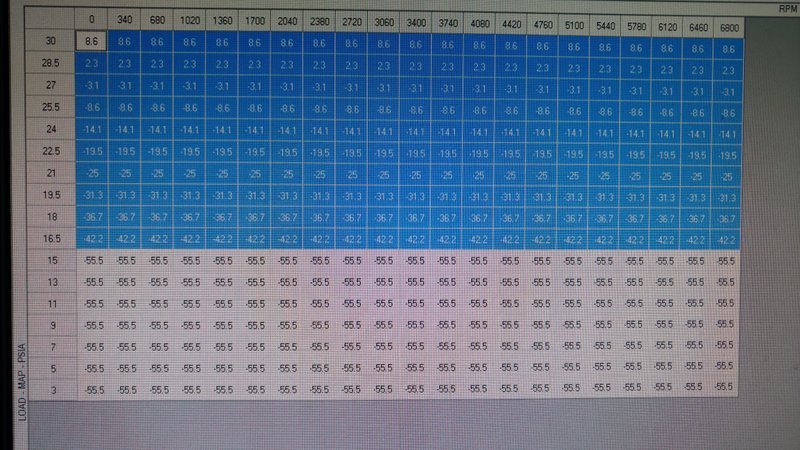

    MAF table is all zeroes. What are your trims and afr at idle?

    If I put my MAF table at 0 the truck won't start. AFR is like 11-13.0 at idle but varies a bunch, 11-13 is the most recent. I haven't looked at trims yet

    Hmm, not sure. I didn't touch a thing with the MAF. Could be o2 troubles like you were thinking. There's a way to tell if it's wideband or narrow. Think wideband has one more wire. Did you use a resistor on the o2 signal?

    Let's see your fuel table.

    What you need to be tuning is your injector pulse width.

    Not 3.5" lol, maybe 2.75"? Think it's actually the size of the stock pipe but for some reason I want to say it's bigger than the pipe the MAF is on stock.
    That is way too much fuel on the top. If you notice my map is almost the same at idle and max load with slightly less in the middle. All the numbers on my map are negative. I can't really make sense of it but my afrs are exactly what I want. It's all based on your fuel trims though, those are the numbers you need to be referencing. I would set the bottom to that -55 and the top to -45 and calculate the middle as a starting point. The only way you can tune closed loop is through the o2 skew so you need to figure that out as well. I may have mislead you before about how to set it up as my procedure was for a narrow band. There is another video on YT for setting up wideband which I haven't watched and it may give you some insight.

    If you can, take a look at what your "load" is under different driving conditions. With a blow through setup my ecu sees 100% load at around 2 psi which at my altitude is near 14.7. This may account for some large differences in what or fuel maps need to be because our ecus are seeing different loads at different MAP values. The load percentage is based on the mafs readings and is also what is used to bracket the ecus fuel table I believe. I think you have a pre turbo MAF? Your ecu might be seeing very small load values compared to mine.

    Gadget had lots of issues but I think he used a MAP ECU 3 which doesn't have pulse width tuning. The FIC 6 does and it should help tune the injectors down. You're exactly right, MAF tuning is not the way to fix this. In fact, the MAF should be capped low and MAP tuning conducted as much as possible.
    Brice, see what your MAF voltage is when you get about 1psi of boost and cap it there. Do all boost tuning using the FIC installed MAP sensor. But before you do any tuning, you need to adjust your pulse width until you are getting an acceptable idle.

    I did the calculations and came up with a injector pulse time of 6ms at 100% volumetric efficiency to obtain a 14.7.
    EDIT: just read all of your comments, I'm using the MAP sensor to tune, but if I make changes to the the MAF table at idle I can make it richer or leaner, but if I mess with the O2 at idle nothing happens...Not sure why this is, and I am idling in closed loop.
