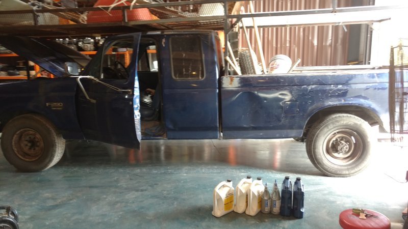

    F-250 7.3L Turbo, non-intercooled work truck
    Takes about 15 quarts of this (2 in the filter and 13 in the engine)

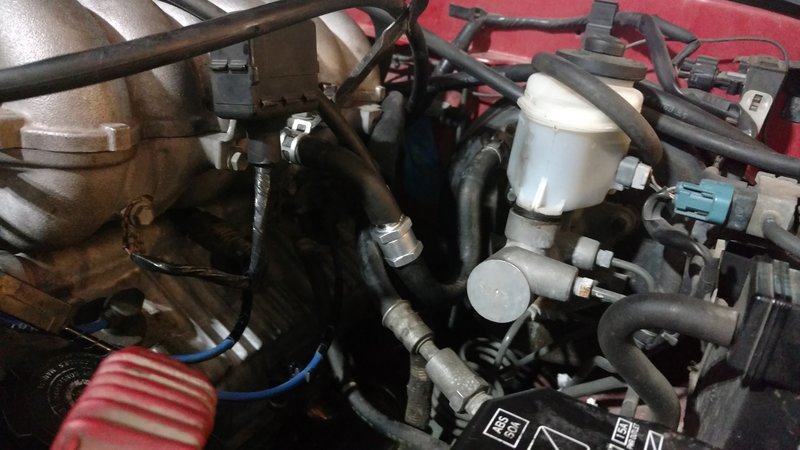

    @Torspd Got that check valve put in there :D I did notice that the brakes are insanely hard to push when the engine isn't on with the check valve there vs stock which would still push relatively easily with the engine off.

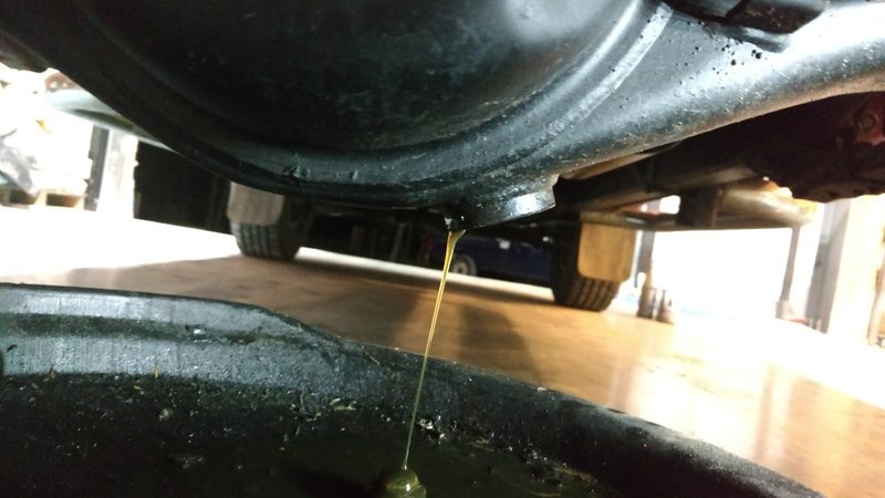

    Time for new diff fluid. I've never changed it, although it was surprisingly clear...

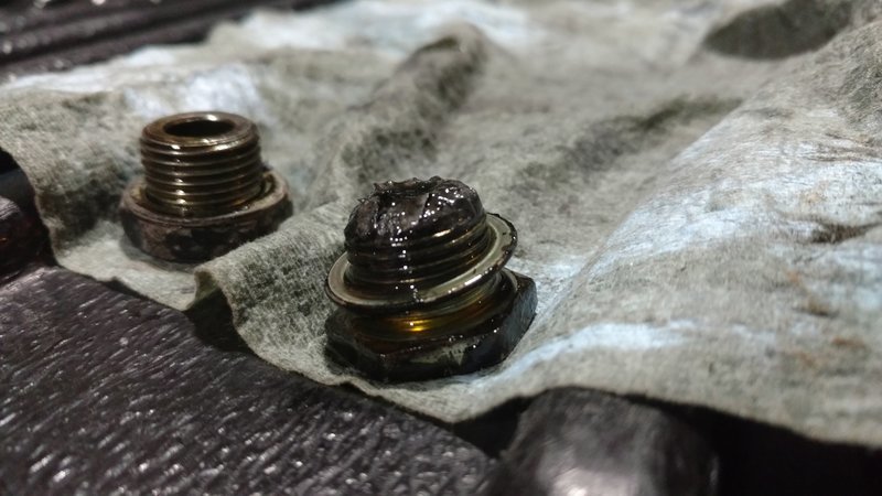

    Metal paste/flakes. The flakes and paste were very thin and fine, so I wasn't worried and from what I see that's pretty normal.
    But considering the build up, it's been awhile since the diff oil was changed. I refilled it with about 3 quarts, or until it ran out of the fill hole. I followed a how to and it said wait 5 mins or so for the axles to seal, so I did. When I came back it was still right below the fill plug (I could feel and sorta see it) so I guess its good? There was a minute or two between each bottle being poured in so I think thats why I didn't have it overflowing out the fill plug. Torqued the drain and fill to 36ft-lbs and yeah all done :D
