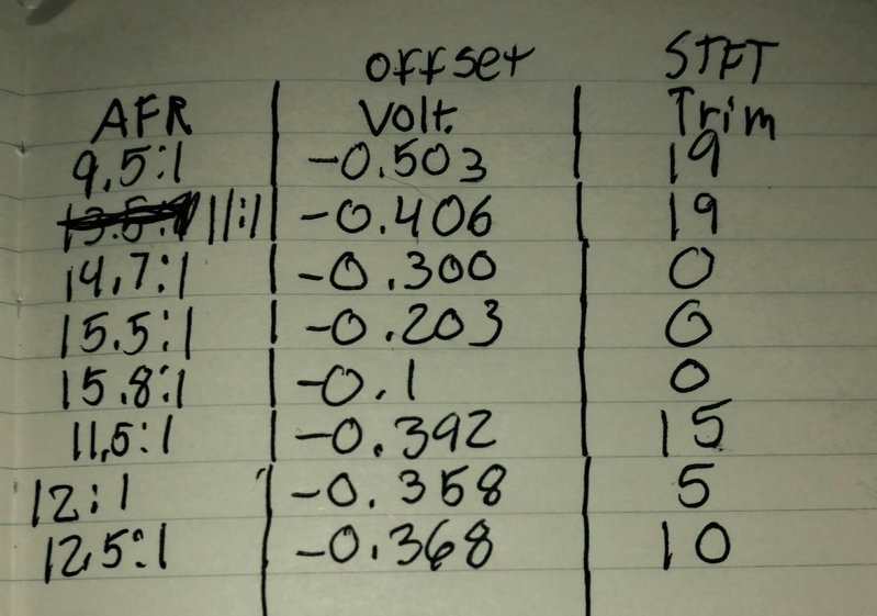

    IMG_20170118_172026.jpg Good news, got the AFRs to adjust :D
    AFR. OffVlt. STFT
    9.5:1 -0.503 19
    11:1 -0.406 19
    11.5 -0.392 15
    12:1 -0.358 10
    12.5 -0.368 5
    14.7 -0.300 0
    15.5 -0.203 0
    As you can see I'm missing some values like 13:1 and 13.5:1, but the above was a accomplished in like 10 min. If anything this proves the AEM's usability to me, whenever you don't screw everything up of course :bananadead:
    So now to set the o2 and fuel maps properly and yeah assuming that goes well I'll get into finer tuning.

    sounds like you're running way too rich...

    Now that there is some progress! :woot:

    Hell Yeah! Finally something you can work with! What did you change to get the o2 skew to actually work?

    Oh and basically what I did to get narrowband tuning was as follows
    Set o2 load to MAP
    Set o2 adjustment values to offset
    Wired in a 10k resistor
    All works like butter :D
    I did try a 1k like vasinvictor talked about, but I unknowingly left my o2 unplugged with the 1k in there, thought the 1k was the issue, soldered in the 10k, realized I left it unplugged, plugged it back in then continued :bananadead::bananadead::bananadead: lol so long story short I used a 10k resistor for skewing, after intending to use a 1k... As you can see my forgetfulness and sort of lack of luck plagues this build...
