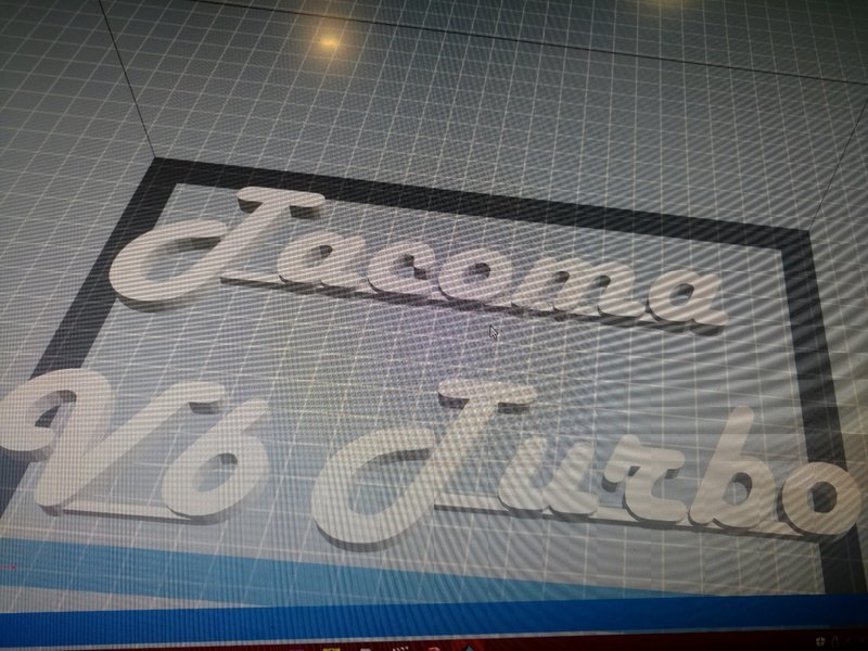

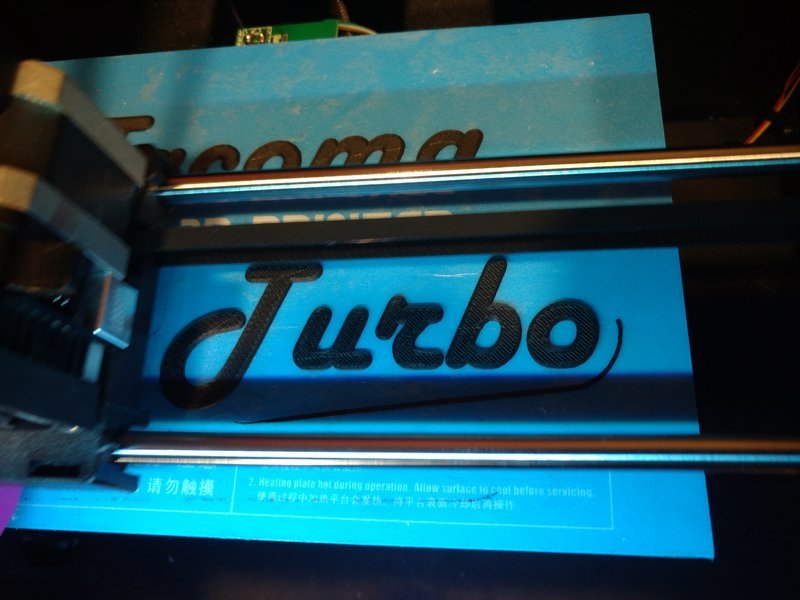

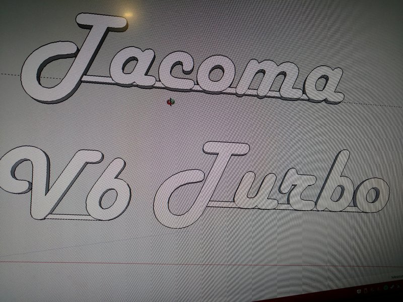

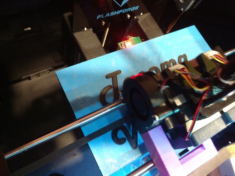

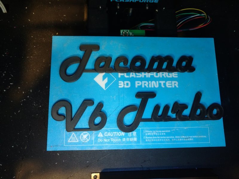

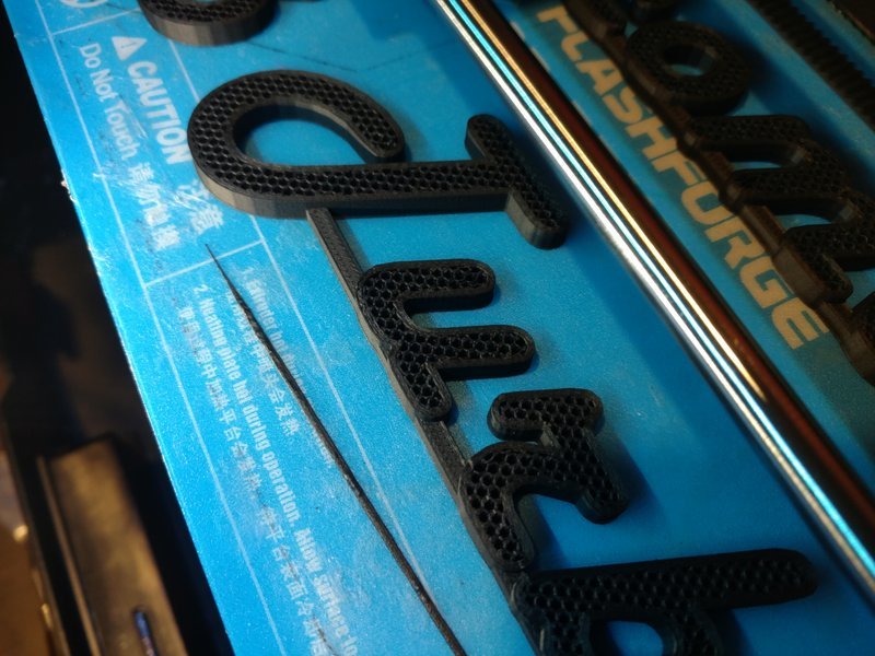

    Until then, I recently got a 3d printer. :D
    I like this font so I figured...why not? (alignment supports added)
    In Flashprint (3d-printer-slicer program)
    Printing V1 no alignment supports
    V2 With alignment supports
    Hexagonal infill @50%
    These are printed in carbon fiber PLA :D. I'll mock these up on the truck tomorrow and paint them as long as the humidity lets up...
    I was going for a 60's turbo charged style font and as far as im concerned I got it. And yes, I know the T looks like a J :D
