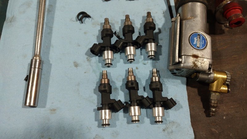

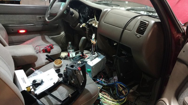

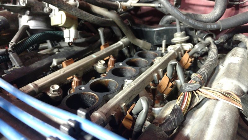

    Tonights efforts to revive the Boosted V6 were unsuccessful... It did run better with stock injectors though.
    I think I fried my AEM wideband gauge when trying to wire it to the FIC6. I hooked the brown wire on the gauge to the sig ground on the fic6 then hooked the white wire to the aux wire on the fic6. As far as I can tell that was correct, but afterward the gauge stopped functioning, even when I unhooked it from the fic6.:confused::(
    650cc's
    wrecked interior
    Stock injectors.
