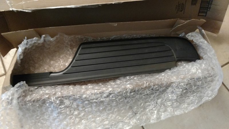

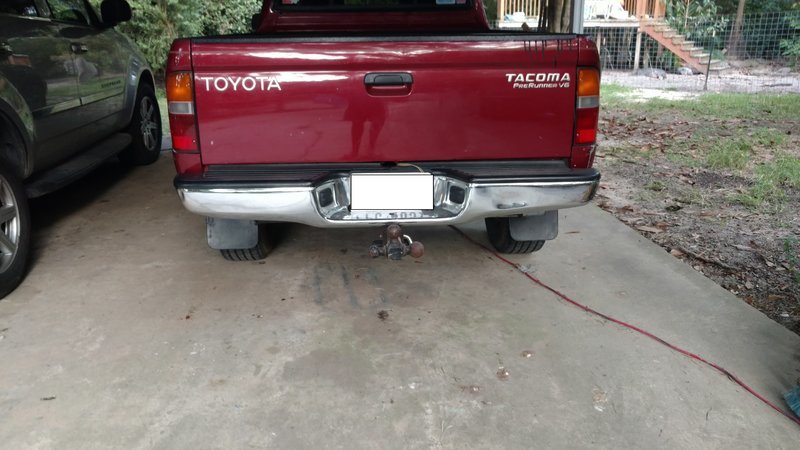

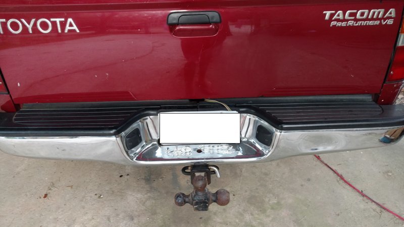

  10. Jul 14, 2016 at 10:08 PM
    #150
    Brice
    Brice [OP] Turbo Member
    May 28, 2015
    #156265
    2,304
    Brice
    Texas
    1999 Tacoma PreRunner V6 SR5
    Wastegate assisted turbo delete
    Finally replaced my left rear bumper cap...:woot:
    @navevang for this thing! Thanks man!
