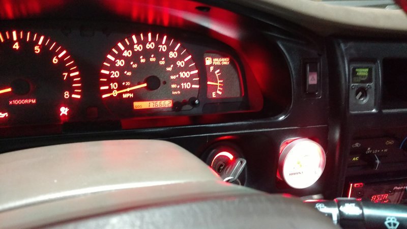

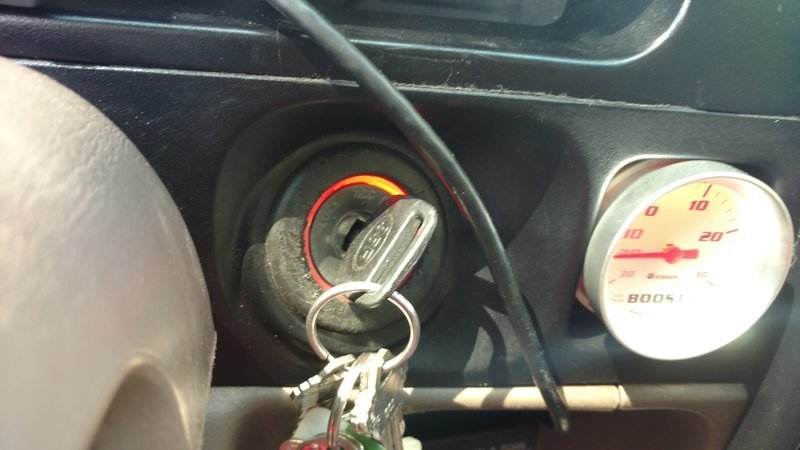

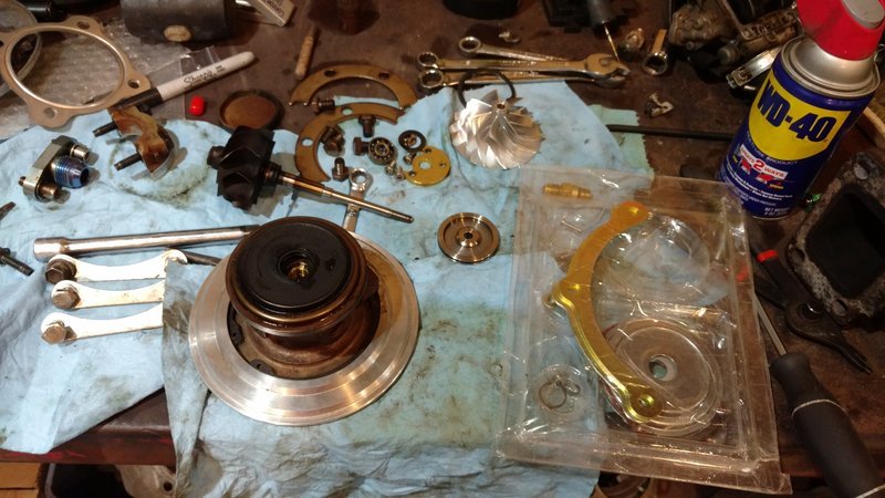

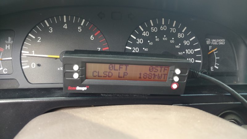

    Some pictures!
    Wrong ebay turbo rebuild kit. (got the right one from CXRacing)
    Boost gauge in clock position, red key halo, color matched LEDs (need to do the the AC switch and HVAC controls still).

    Trims

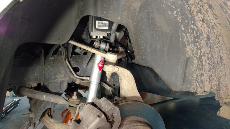

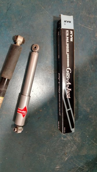

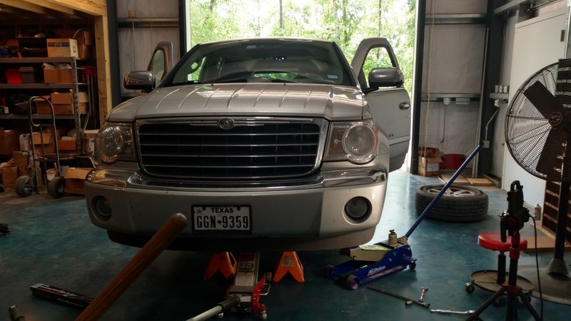

    Changed the shocks on the aspen
    KYB gas shocks. These improved handling and ride quality all around imo, way less body roll and bounciness.

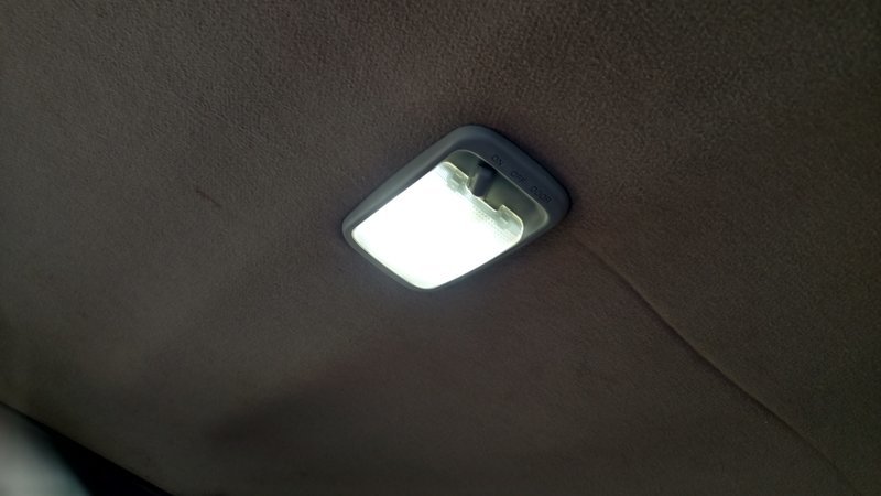

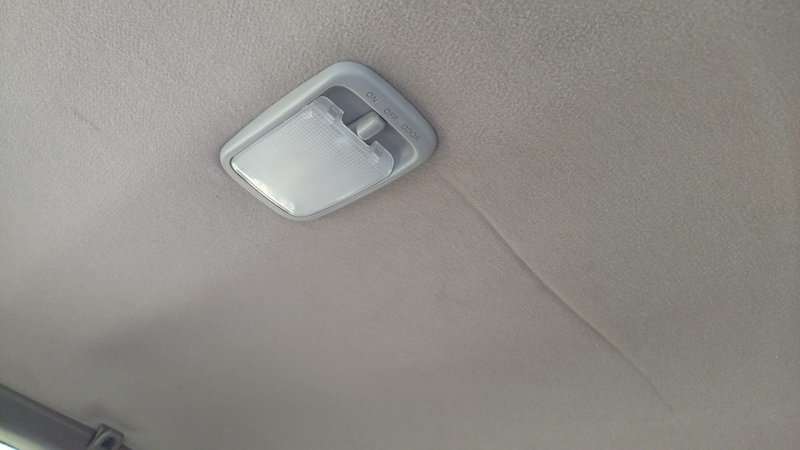

    @DRFTR Thanks for the dome light! I promised a shout out to you, better late than never!
    Works good :D
