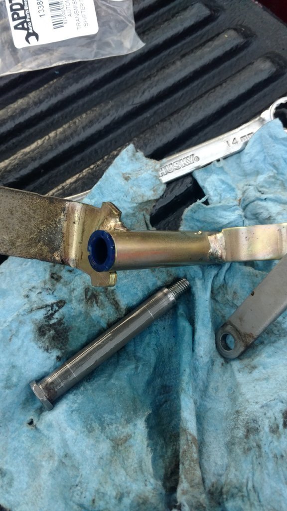

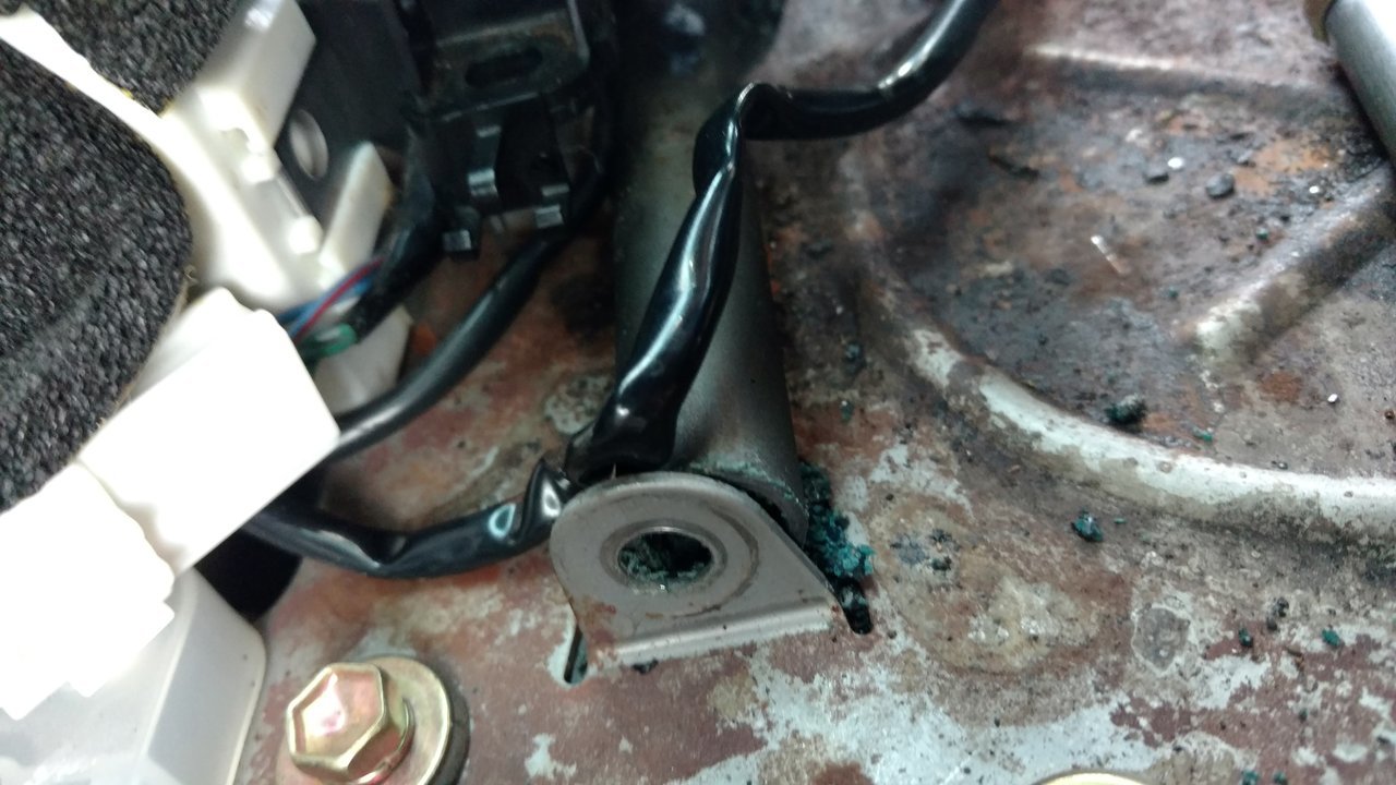

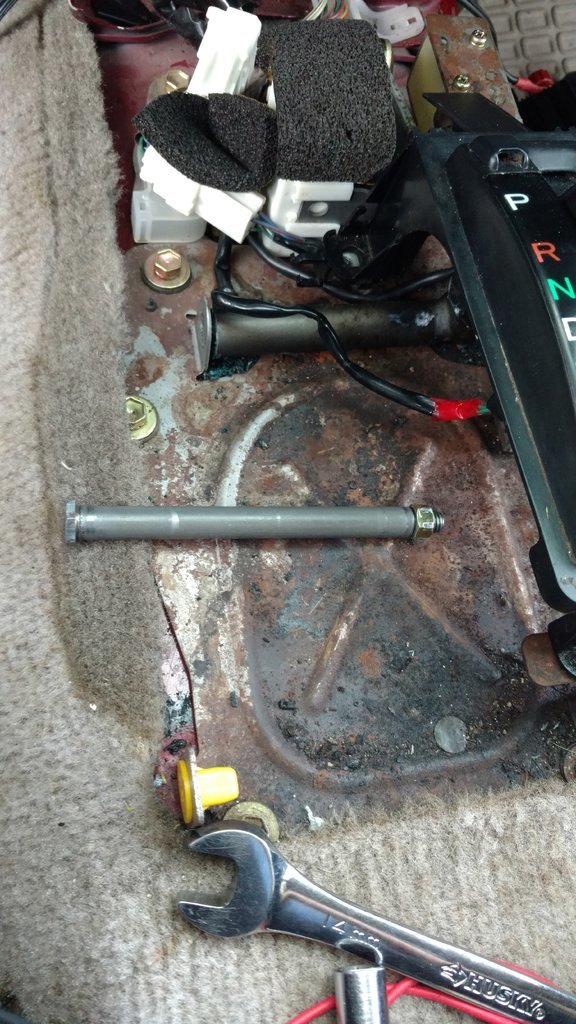

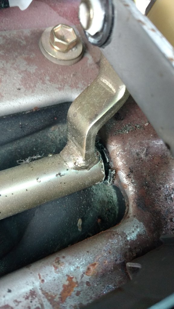

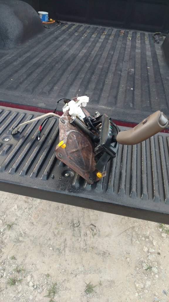

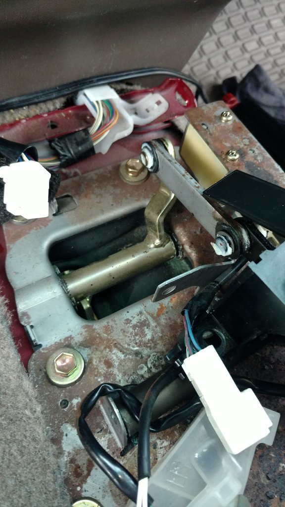

    Here's what I've done recently :D
    • Replaced my shifter bushings
    • Replaced my carrier bearing
    Apparently 1st gen autos had bushings in the shifter, who knew? I replaced mine with some off of Amazon, and I'd say they're well worth it. They make the shifter feel much better and tighter, giving it a very heavy detent that makes it feel like it's actually in gear.
    You can find them here: https://goo.gl/WU6H11
    Stock ones WERE a hard plastic from what I've read^
    As you can see mine have degenerated
    More pics
    New bushings
    Reassembled

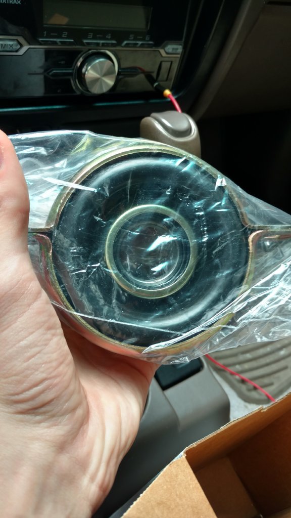

    New carrier bearing. Old one was OEM I think and had a cracked boot, dried grease and clicked. No good. Old one had tons of play, about 1-1.5" and the new one is much tighter at about half an inch of play.
    After tightening everything up (shifter and carrier) I've come to find my transmission mount/bushing needs replacing. I found this when I tried leaving a red light in a swift fashion and my truck decided to shift itself into neutral lol...not supposed to happen. So thats immediately next :D

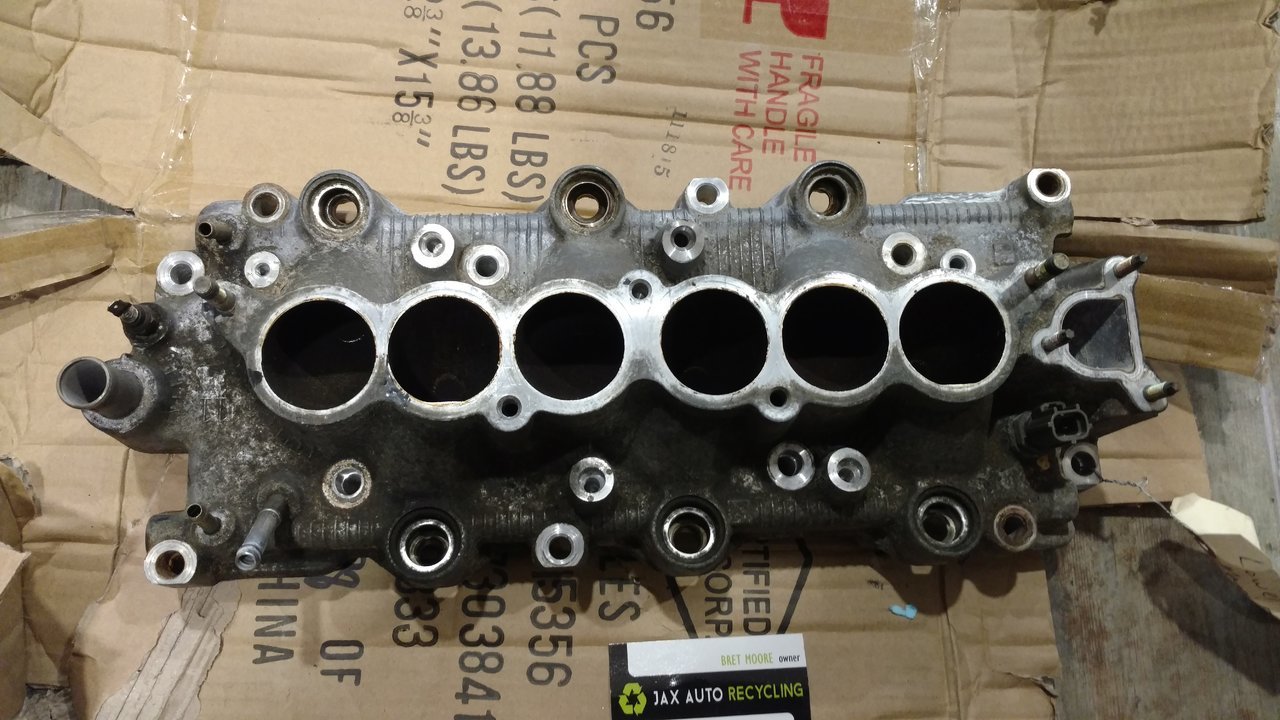

    I ordered a lower intake plenum for a 5vz, for testing purposes :D
    I didn't wanna mention this too soon, as to not let anybody down, because this project may be a flop. However I'm going to attempt to make a performance intake manifold for our trucks.
    Again I don't wanna get someone's hopes up, because this may not work out in my favor, but the current plan is for a turbo manifold (potentially an N/A one too), reasonably priced, that moves the throttle body away from the downpipe, and hopefully flows better than stock.
    I'm putting this out there now to see who may be interested. The lower intake is in the mail as I type. Until then I'm doing some research into custom manifolds, runner length, plenum volume and stuff like that.
