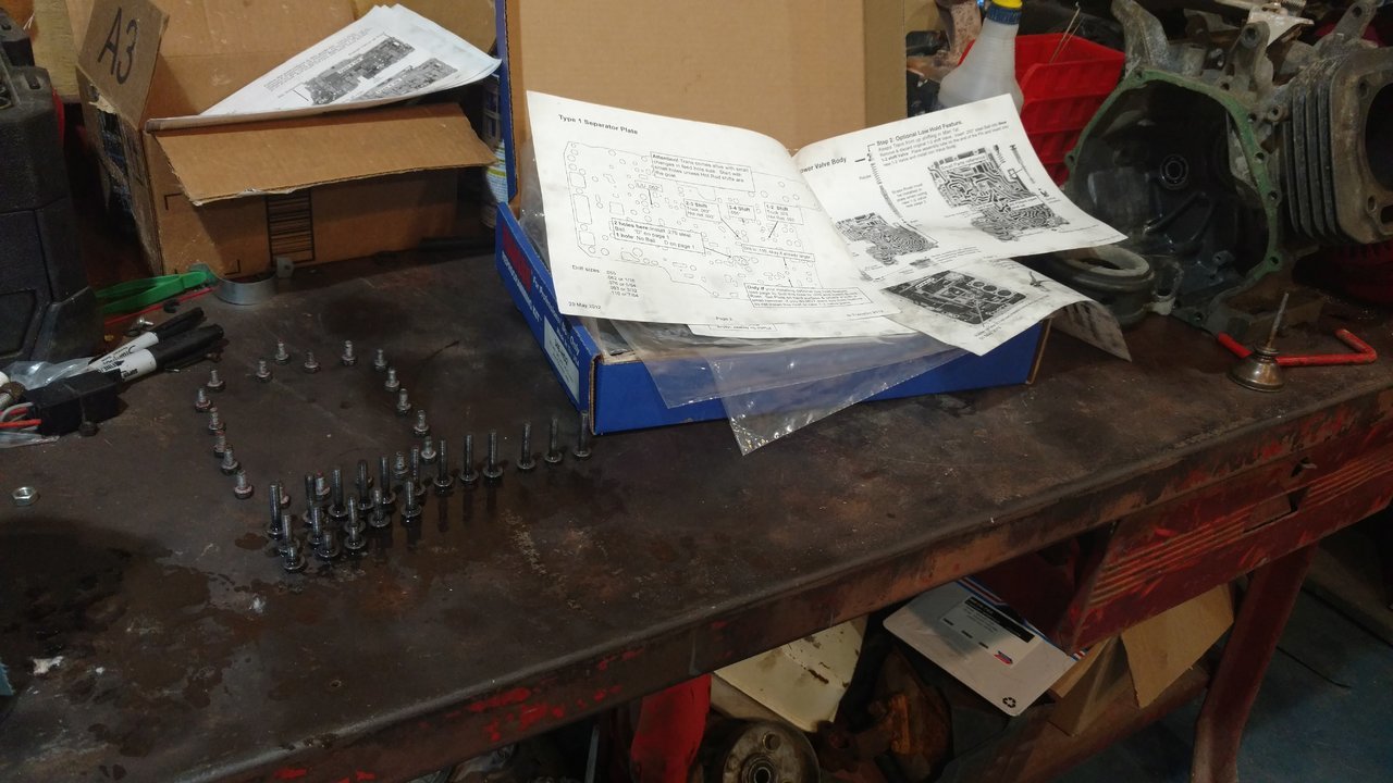

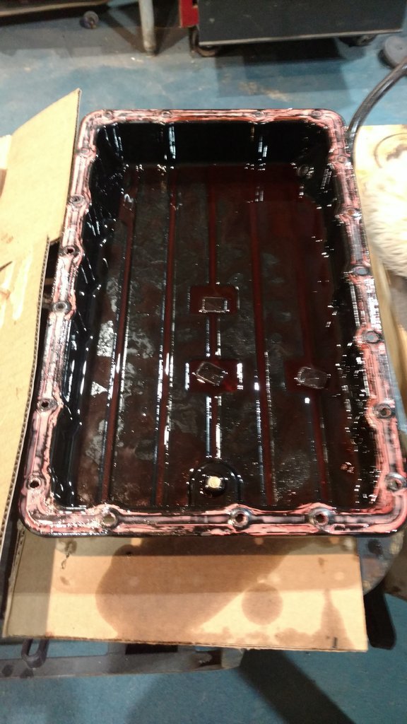

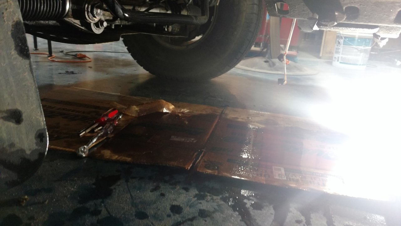

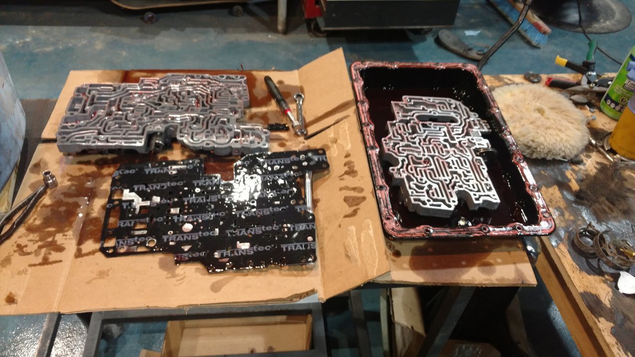

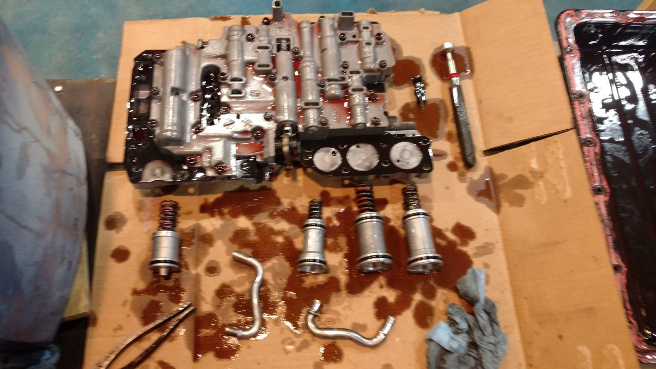

    Ok so while I was fixing my kick down cable I decided to see if I could solve my harsh reverse issue.
    IMG_20170711_200902433.jpg IMG_20170711_200928749.jpg IMG_20170711_200914477.jpg IMG_20170711_201145477.jpg IMG_20170711_203117432.jpg
    Once I got the valve body apart I realized that I installed a pressure valve backwards. Not too good. I've since fixed it and am reinstalling today.

    Man, I did not enjoy doing my valve body work.. on the garage floor and everything too.
