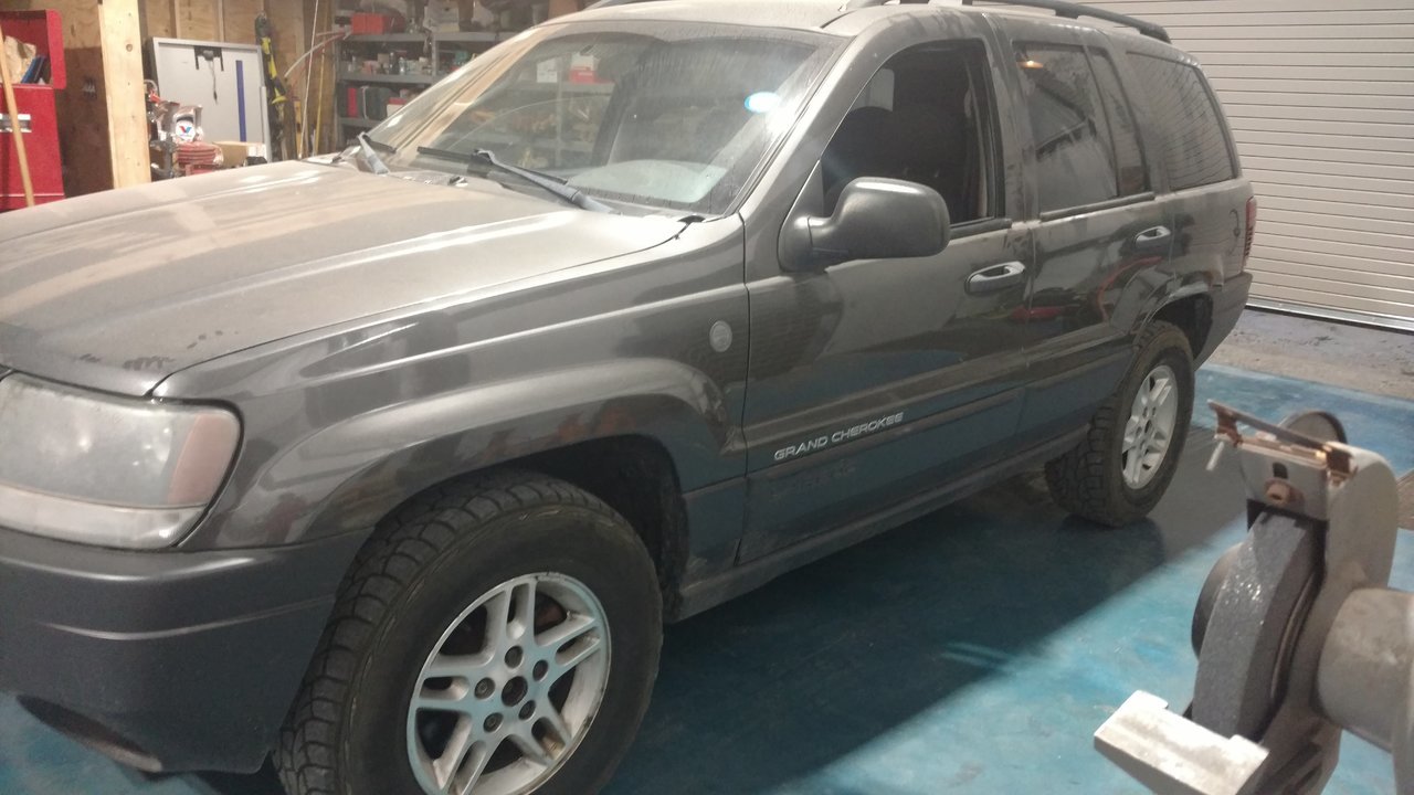

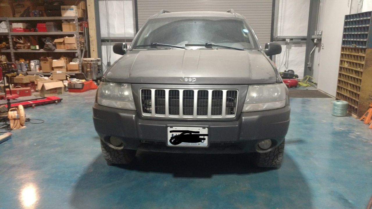

    2004 Jeep Grand Cherokee $1000. Blown head gasket. Wasn't too bad though as I drove it home :D
    157,221 miles and a 4.7 V8-non-high output

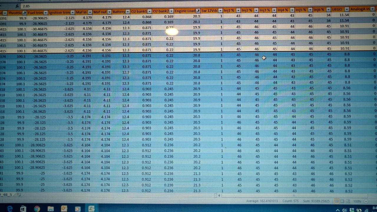

    What you see above is my current misery, I mean an AEM log file.
    So I'm having a little trouble with the new 550cc injectors I just installed (and will post more on later). Well not the injectors, but open loop is the trouble. So I got closed loop fueling down pretty good at 11.5-11afr in boost and like 12.5 at atmosphere, all the way till open loop where it decides 8:1 is a good ratio to have. This occurs at about 3400 rpm at WOT and I haven't found a way to get it up from 8:1, and whatever MAF clamp I set seems to not work. my current clamp is at 4.5v and I tooled around with voltages below that but they seemed to have no effect...
    Also sorry for the lack of updates for anyone who enjoys my build, I've just started college and I'm just now getting organized.
    @Clay_916 @vasinvictor

    Based on that log it looks like you're achieving those afrs in CL because your fuel trims are maxed out negative and the ecu can't cut any more. Set your OL desired afr using the fuel map of the fic and use the o2 map for CL.

    I am using the o2 map for closed loop, those trims on there represent the AEM's fuel map, for instance I'm subtracting -48% at idle and and at that particular spot it's minus -26~% for boost. I guess -26% fuel in open loop is different than -26% fuel in closed loop...
