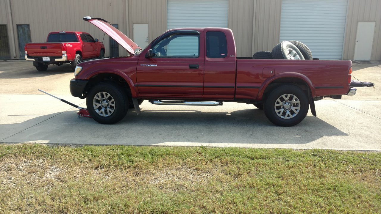

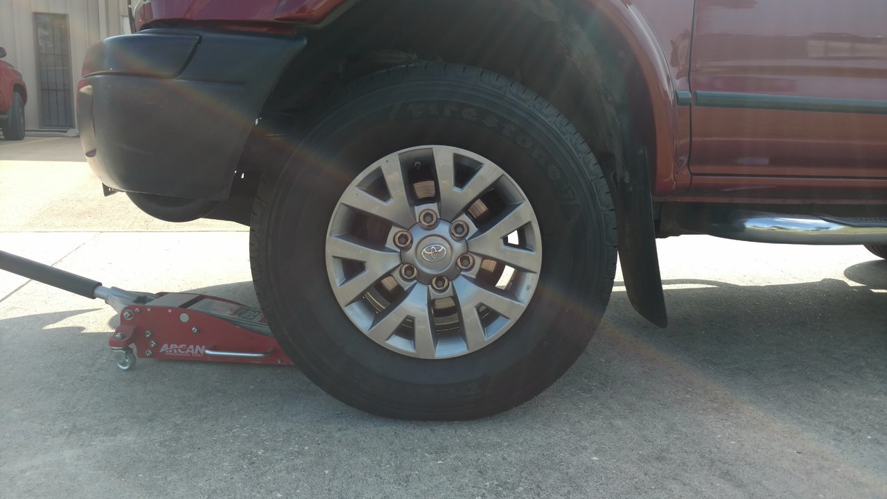

  13. Oct 11, 2017 at 12:25 PM
    #1733
    Brice
    Brice [OP] Turbo Member
    May 28, 2015
    #156265
    2,304
    Brice
    Texas
    1999 Tacoma PreRunner V6 SR5
    Wastegate assisted turbo delete
    Alright so apparently the 1st gen offset is different than the 3rd gen offset which means I'll need spacers to correct it (No I don't wanna argue about spacers lol)
    I believe 1st gen offset on the 15x7 Prerunner wheels is +3.25 and the 3rd gen offset is +4.5. This means I need a .75" spacer to correct it?
    Do you guys know of any good spacer brands? (@Torspd) It's sorta hard to mess up a hunk of billet aluminum so I figured as long as I get one with quality studs I should be ok.
    Also do y'all have any recommendations for spacer thickness? Most places only sell 1"-3" Although I don't wanna go over 1.5"

  15. Oct 13, 2017 at 11:19 AM
    #1735
    Brice
    May 28, 2015
    #156265
    2,304
    Brice
    Texas
    I ended up buying the rims and tires! 180 miles on the tires and wheels and they are in great shape. Truck also rides much better with newer better balanced tires :D
    I think I may have to swap my lugs to the washer style vs the centering style
