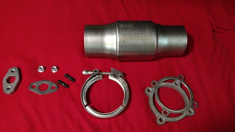

    Got me some parts, high flow cat for the fastest meow's, a 4 bolt flange for adapting the down pipe and an o2 bung for the post cat o2 sensor. (gotta read all those meows to get the best AFR's). Oh and a vibrant performance 3 inch V-band

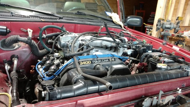

    Removed my stock air box and intake.
    Nice view of what i got myself into...

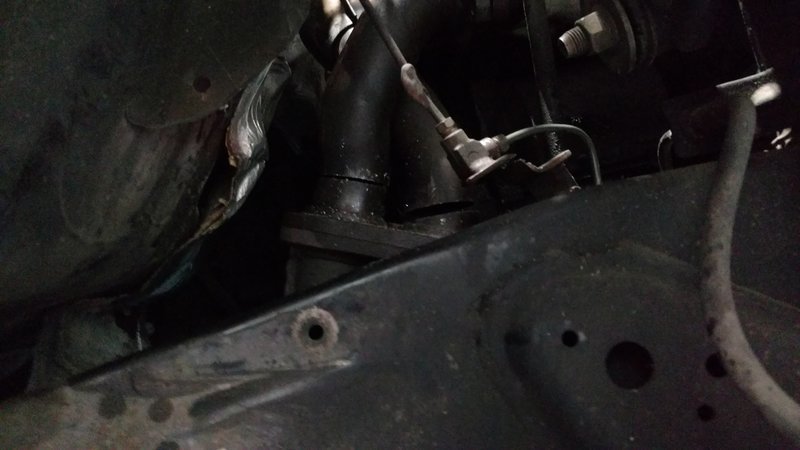

    managed to get the crossover junction cut(as well as some of my brake bracket... :D lol) and unbolted on the driver's side,
    more to come tomorrow when I get the manifolds off. These bolts are EXTREMELY tight... My breaker bar is about 3 ft long too lol.
