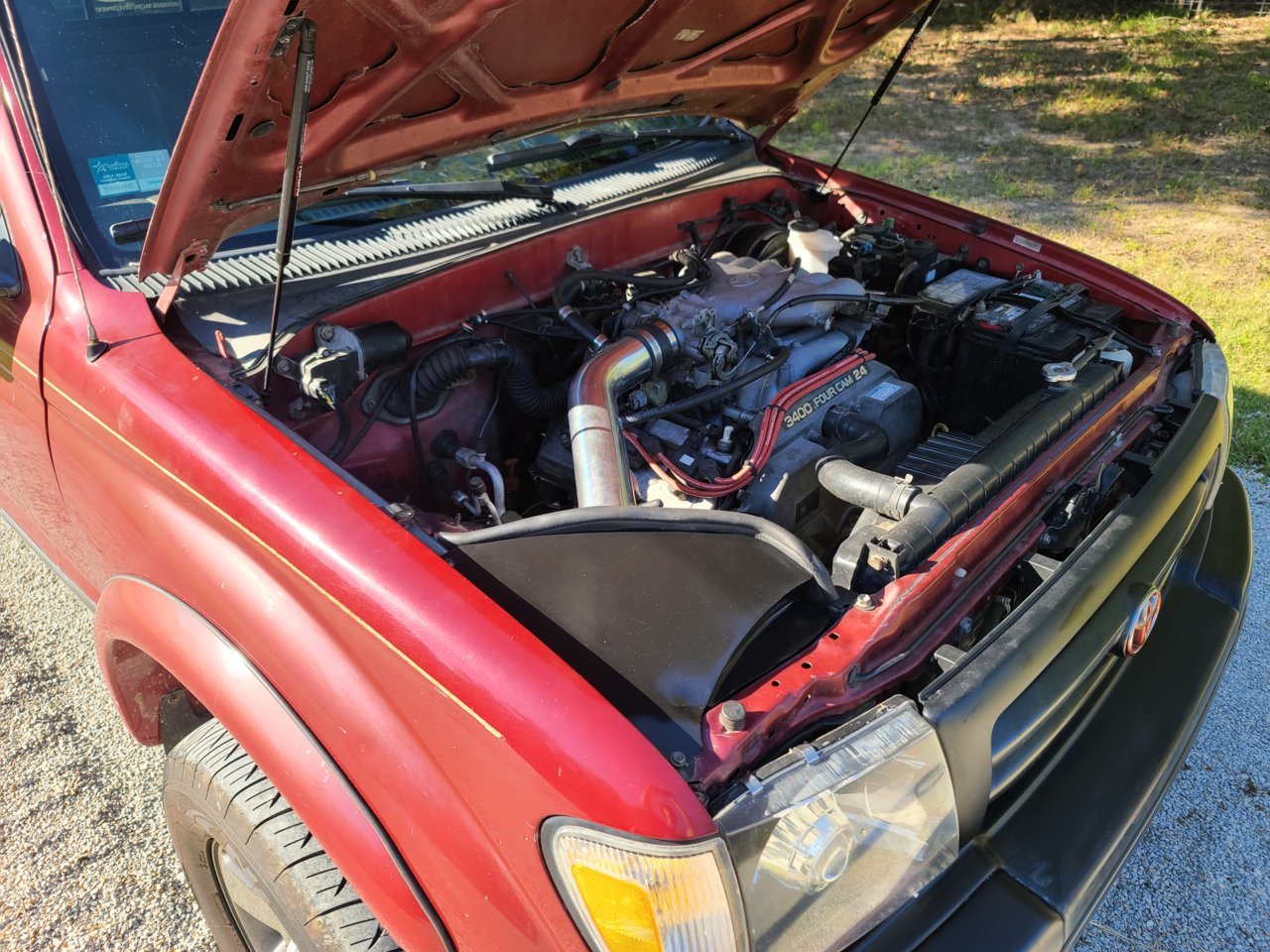

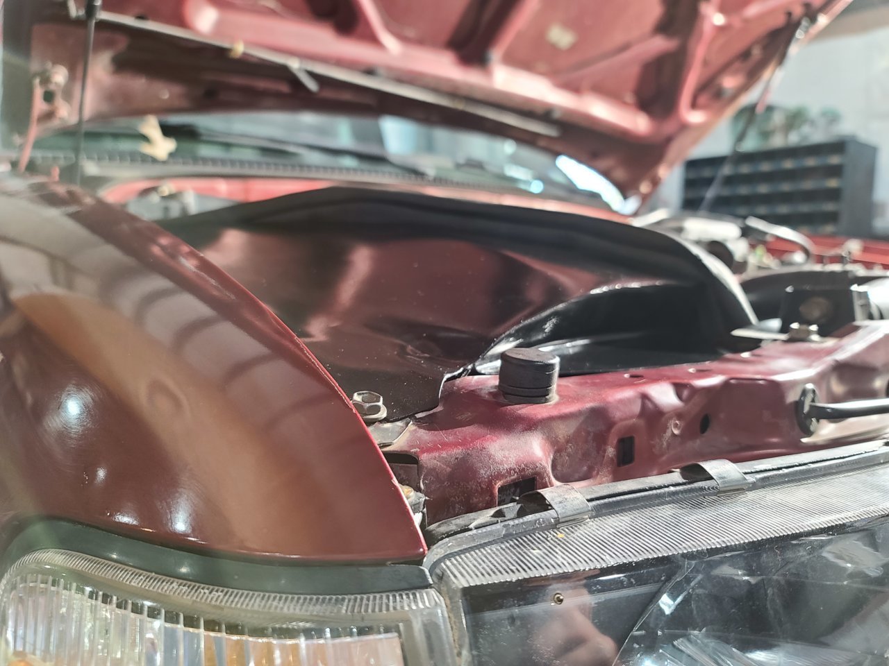

    It has been awhile... This truck is now my daily driver. The turbo manifolds have been removed along with the AEM FIC. Without the turbo the transmission wasn't getting up to temp in regular everyday driving so I added a 180F thermostat. I also installed a cheap eBay intake, re-gapped the plugs and bought stock manifolds and crossover along with a new 2.5" exhaust with my 2005's old muffler.
    I cant remember if I covered it before but the turbo setup was removed due to the fact that I plumbed the wastegate incorrectly and over-boosted to 24 PSI at WOT. Surprisingly the motor took it, but the cheap turbo did not and the compressor wheel collided with the compressor housing, so stock we are. For a few seconds the truck was incredibly fast, quite literally the fastest thing I've ever experienced...

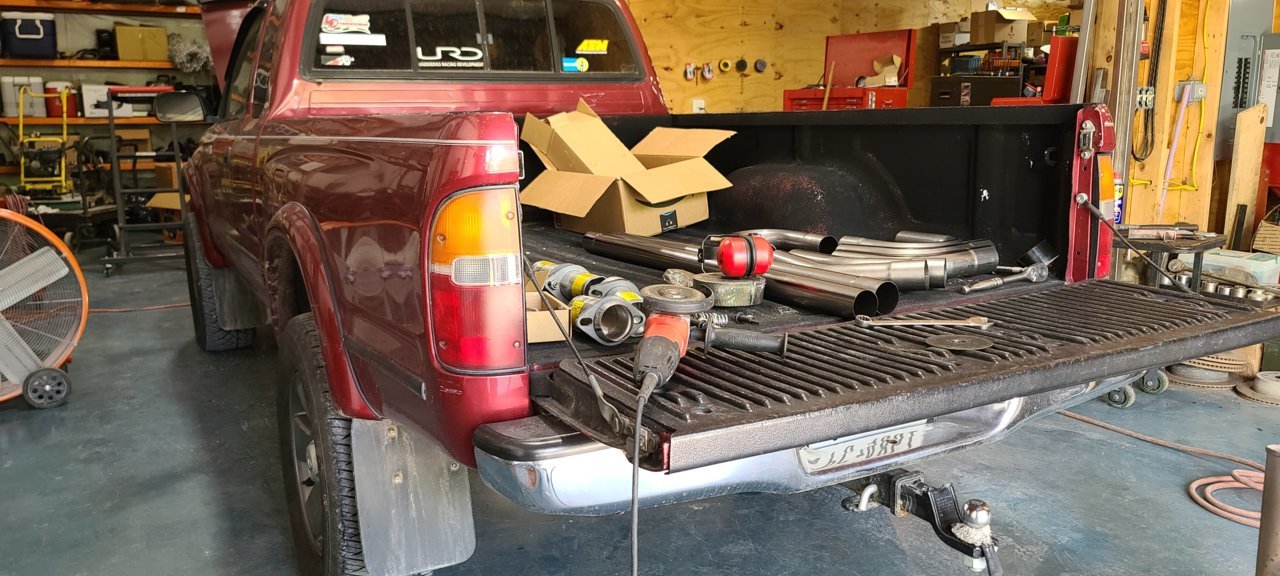

    Sold the old daily in a sellers market
    Some random exhaust parts

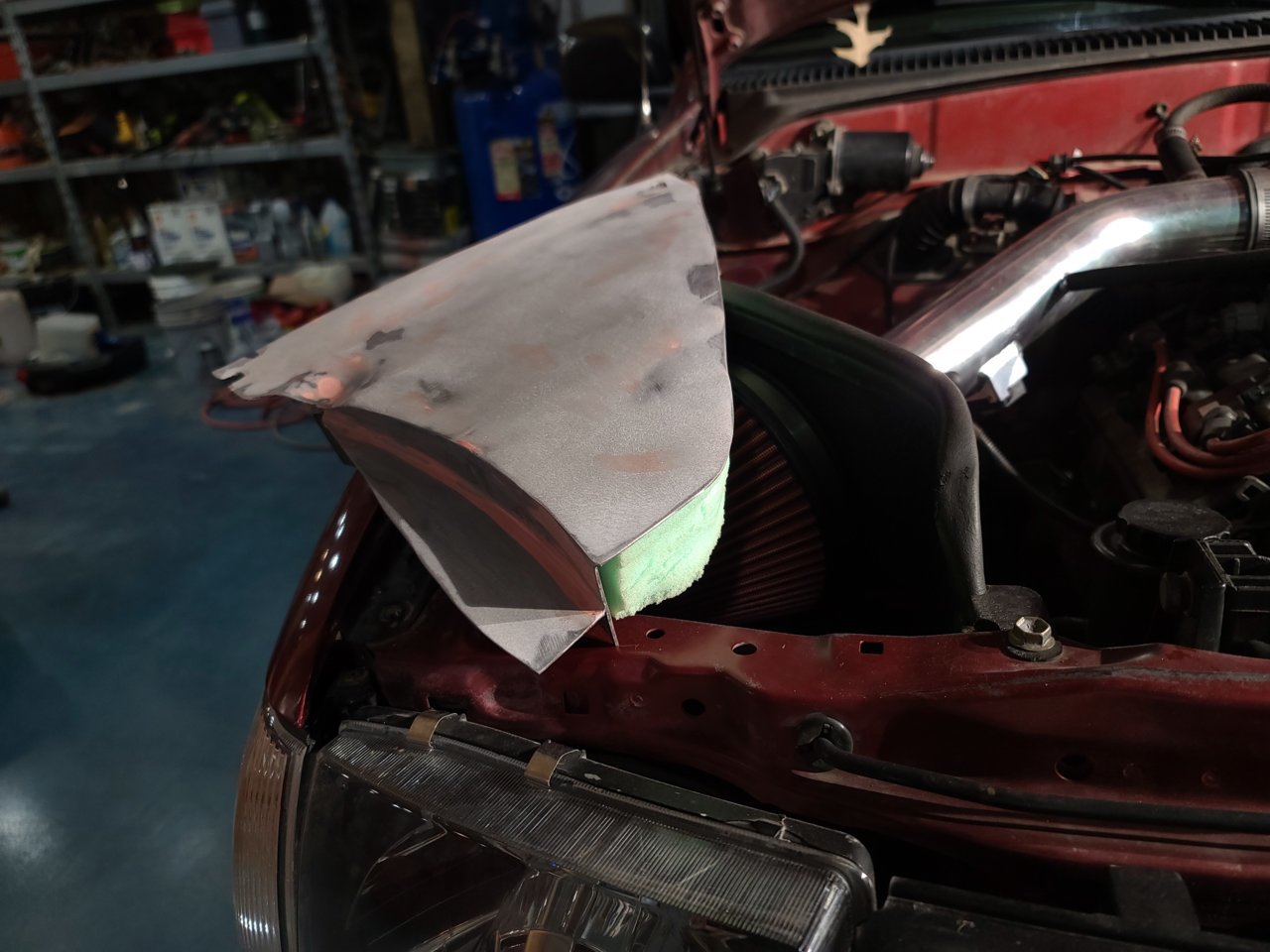

    New intake was waaayyyyyy too loud so I made this sheet metal cover with some foam.

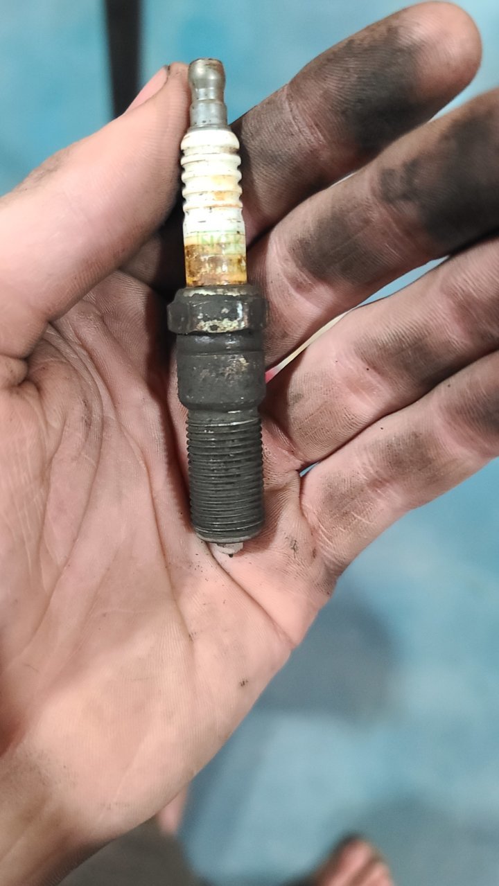

    A friend of mind did the driver side sparkplugs on my 05 a couple years ago and neglected to torque them after. The result was a something that sounded like rod knock once the engine was warm, scared me half to death. Honestly surprised it ran as well as it did.
    For reference, the offending plug:
    Notice the missing ground electrode. Never had a miss code and the plug was only like 5 threads in so that's cool.
