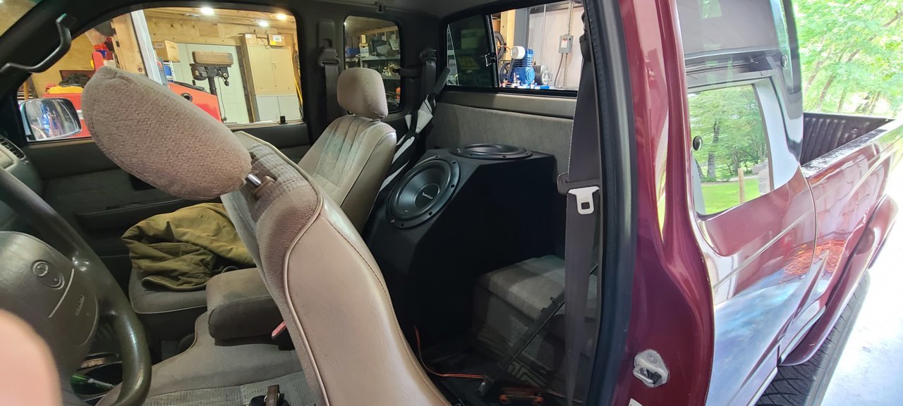

    Currently installing my 2 10"s from my 05. Went ahead and smoothed the box out with a da sander and router then sprayed it with bed liner, gotta say it looks much better.

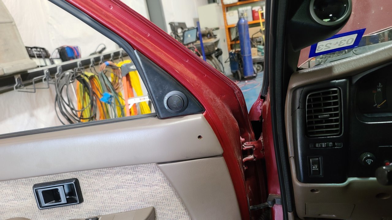

    Put some tweeters in the doors awhile back and it has made a world of difference as far as music listening goes. Feel like listening with subs for the first time, everything is so clear.

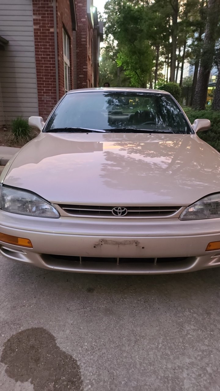

    Ended up buying this as a daily. 1996 Camry LE 5SFE with a the 4 speed auto. It's had some work done to it but that'll be for another post.

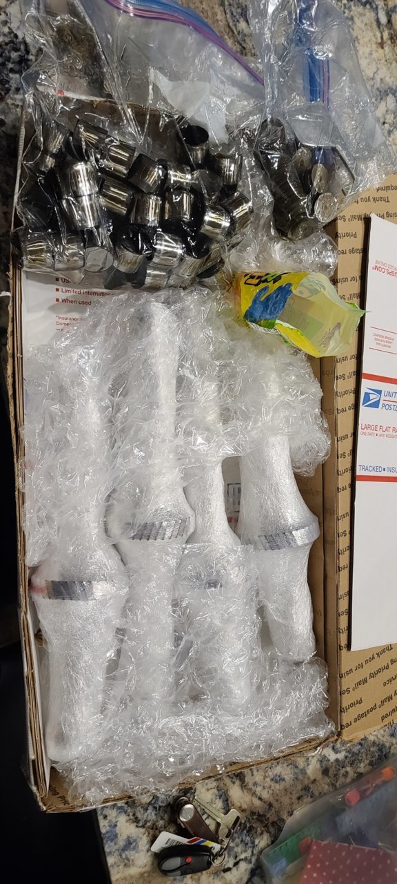

    The reason for this post is mainly:
    That right there is a set of 3vzfe cams with shims and shim under bucket, buckets.
    I've made up my mind on what I wanna do with this truck and I've decided to go ahead and just build the 5vz. I'll be swapping these in on the stock ecu for shits and giggles to see how it responds.
    The reason these are happening first as opposed to any other parts was because this full set of shims, buckets and cams was only like $350 on ebay and I couldn't pass it up.
    The next step will be a full stand alone ecu. The truck is NA right now and I wanna learn to tune it NA before I boost it to figure out how it behaves with fewer variables. Current looking at AEM's Infinity 3 series.
    Stay tuned :D

    Well I can confirm they fit. I never got around to testing how they run
