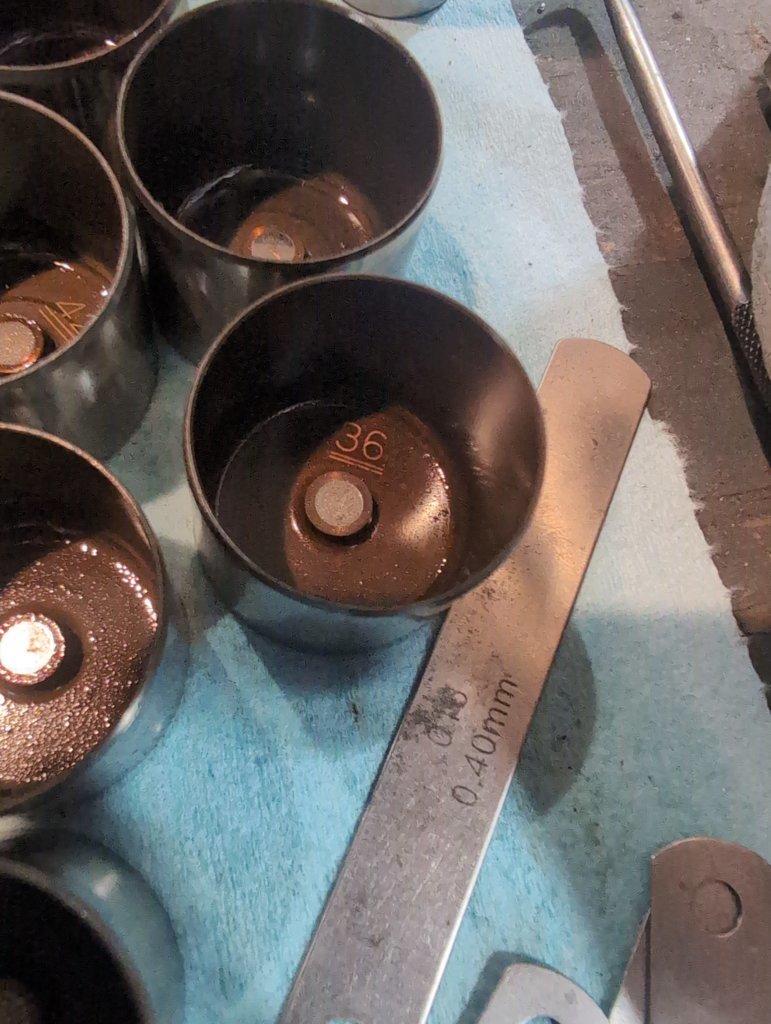

    I'm using stock 3vzfe buckets, they vary in thickness from like 33 to 43? (Idk what the numbers mean). I plan to use a haltech of some kind. I'd like to rev this engine to 7k ish and the bottom end geometry is very favorable to that, I'd just be scared those shim over buckets would hop out, maybe they won't with stiffer springs though.

    Here's what they look like up close, the "shim" is built in I guess

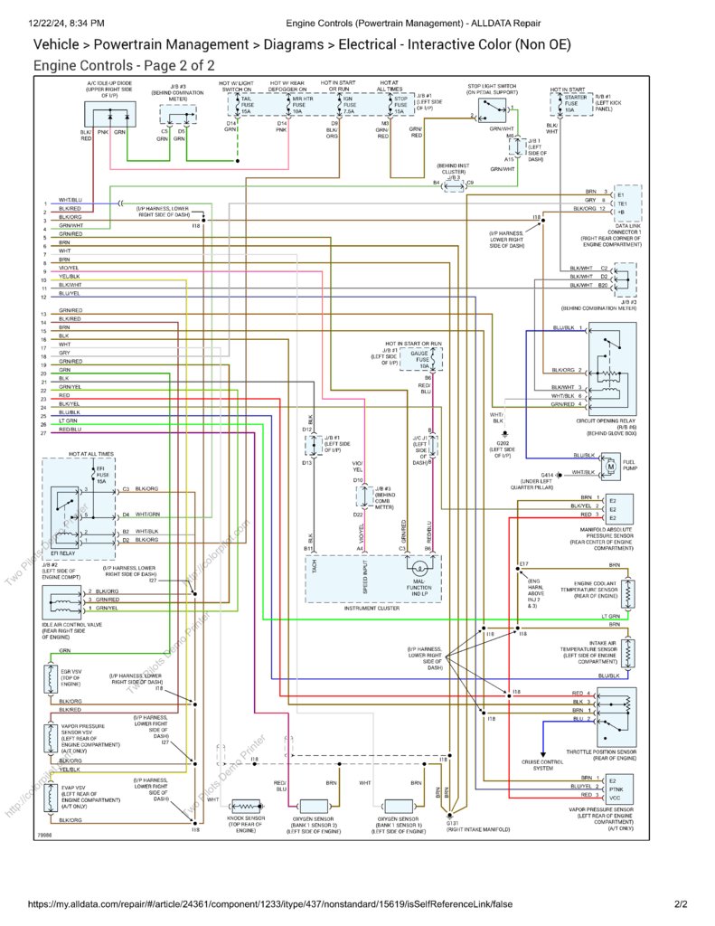

    While the relay was certainly on its way out and the coil needed swapping after i messed it up...neither thing has solved my issue. Now upon turning the key the p1300 code pops up immediately. As far as I know I've touched every part of the ignition sytem except the crank sensor and I assume the hal effect sensor in the distributor is good since it cause a consistent response on the multimeter.
    I've pulled the ecu to inspect for any burn or damaged looking components...but it all looks fine...
    Truly I have no clue what the deal is

    The crank and cam position sensors are on the same circuit here too, very weird setup...
