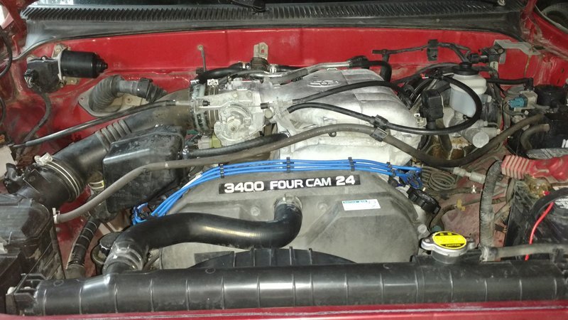

    Lil update.
    Truck was running like crap recently and couldn't figure out why.
    I scanned it with my SG2 and it returned some MAF codes, figured yeah makes sense, as far as I know it's the original MAF. So I replaced it....but of course that wasn't the issue (or atleast all of it).
    As it was still idling around like crap i decided to take it out for a short drive to see if Mr. ECU needed to learn the new sensor. Nope.
    The SG2 now began returning codes: P03000, P0302 and P0306, meaning I had random misfires and was definitely misfiring on cylinders 2 and 6 (P0302 and P0306) Spark plug wire or ign boxes.
    And so today I replaced whatever cheap-no name plug wires and boots the truck previously had with a set of blue NKG Plug wires and boots, and Bob runs better than ever before!:burnrubber:
    I noticed idle was a helluva lot smoother too. And replacing the old MAF couldn't be too bad as I'm about to boost this lil thing and it'll need all the help it can get lol.IMG_20160624_161258695.jpg

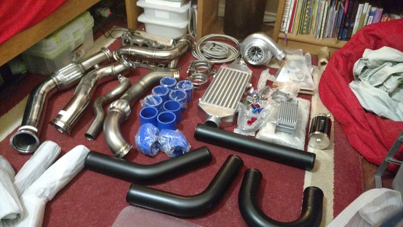

    The goodies from CXRacing came today, and they include:
    Turbocharger .70AR cold .63AR hot, billet wheel and ceramic bearings
    Turbo manifolds, crossover and downpipe.
    Intercooler and intercooler piping
    silicone couplers
    two 2.75" to 2.5" inch adapters (for MAF)
    V Band flanges (which i have a plan for)
    And all appropriate gaskets.
    So before i get one of these :worthless:
    here yah go!
    Some things in the picture weren't mentioned above but will be included when I finish the project and attempt to create a 1st gen 3.4l Turbo dictionary sticky thread.
    (so that way people such as my lazy self can have all the info they need to turbo there 3.4 all in one thread!)
