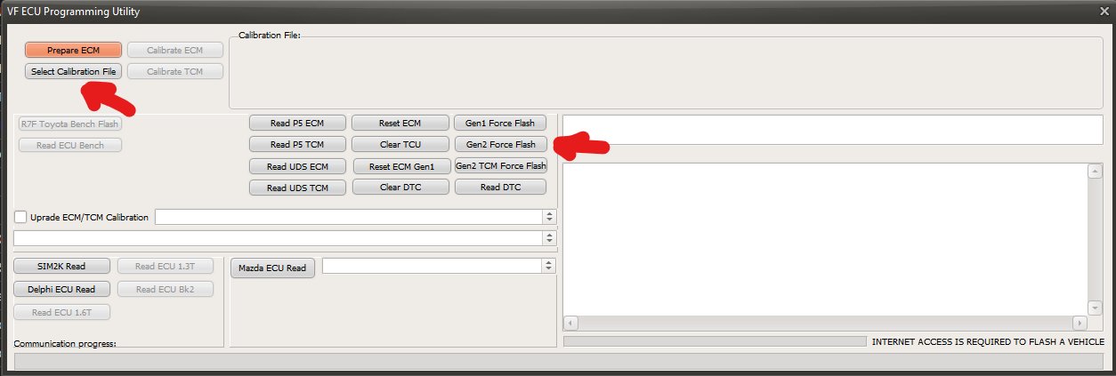

    If you bricked while flashing it, it should be easy to recover.
    1. Open the vftuner software, flash program. (Ignition on)
    2. Do not click prepare ECM, click select calibration file and select the file.
    3. Click Gen2Forceflash and let it finish.
    4. Turn off ignition then start truck.
    After this process, you can do your tune flash again like before.

  17. Apr 18, 2023 at 7:03 AM
    #17
    tonered
    tonered bartheloni
    Sep 25, 2017
    #231055
    31,116
    tony
    Lynnwood, WA
    You can unbrick using the recovery / force flash function in the vF Tuner software. I have never needed it, but it is apparently very robust.
    -- Do not hit Prepare ECM.
    -- Just Select a tune file. The Stock file with matching ECU ID is recommended for most folks but folks with S/Cs seem to do well with the Magnuson tune file for some reason.
    -- Then, hit the Gen2 Force Flash for late model Toyotas, including our 3rd Gen Tacos.​
    You can try this repeatedly to unbrick your ECU.
