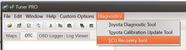

    go to Vf tuner website and click the resources tab. Step by step instructions on what to do.

    @surf19 take a breath and relax, you will be good! If you haven’t already, you need to follow the procedures to request an Access Key for recovery from VFTuner. Do you know how to do that?

    VF Tuner is OV Tuner. Head over to the VF Tuner website and go to the resources tab and find the instructions for ECU recovery.

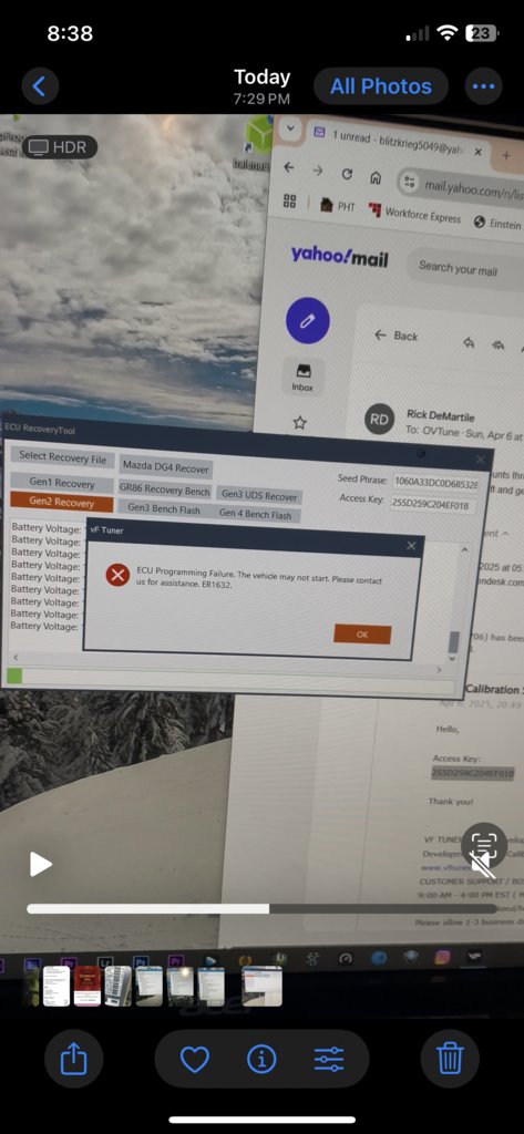

    #198
    blitzkrieg3002
    blitzkrieg3002 Well-Known Member
    May 30, 2016
    #188296
    1,219
    Rick
    California
    2019 Tacoma SR5 4x4
    Bricked my ecu tonight trying to flash a tune. Performed the recovery method with the access code and still did not work. Something's up with vf3.0 I never had problems flashing prior to this. Very strange. Will see what vf support advises me to do next...
  19. Apr 6, 2025 at 8:34 PM
    #199
    Stormpeacock
    Stormpeacock IG: @storm.peacock
    Mar 2, 2020
    #320942
    684
    Rich
    Atlanta, GA
    19 Cement Offroad
    MCB Elite Performance Tuned 5.29 Differential Gearing 35" Kenda M/T on Steelies SOS Bumpers, Skids, and Sliders Ranch Camper Shell
    dang the recovery tool didn’t work on a vfc file flash? Can you give more details on what happened during the flash process?
  20. Apr 6, 2025 at 8:41 PM
    #200
    blitzkrieg3002
    May 30, 2016
    #188296
    1,219
    Rick
    California
    2019 Tacoma SR5 4x4
