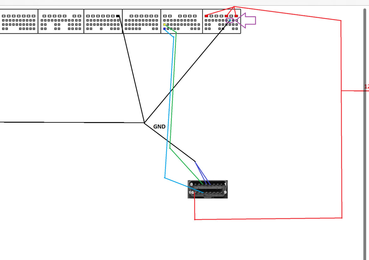

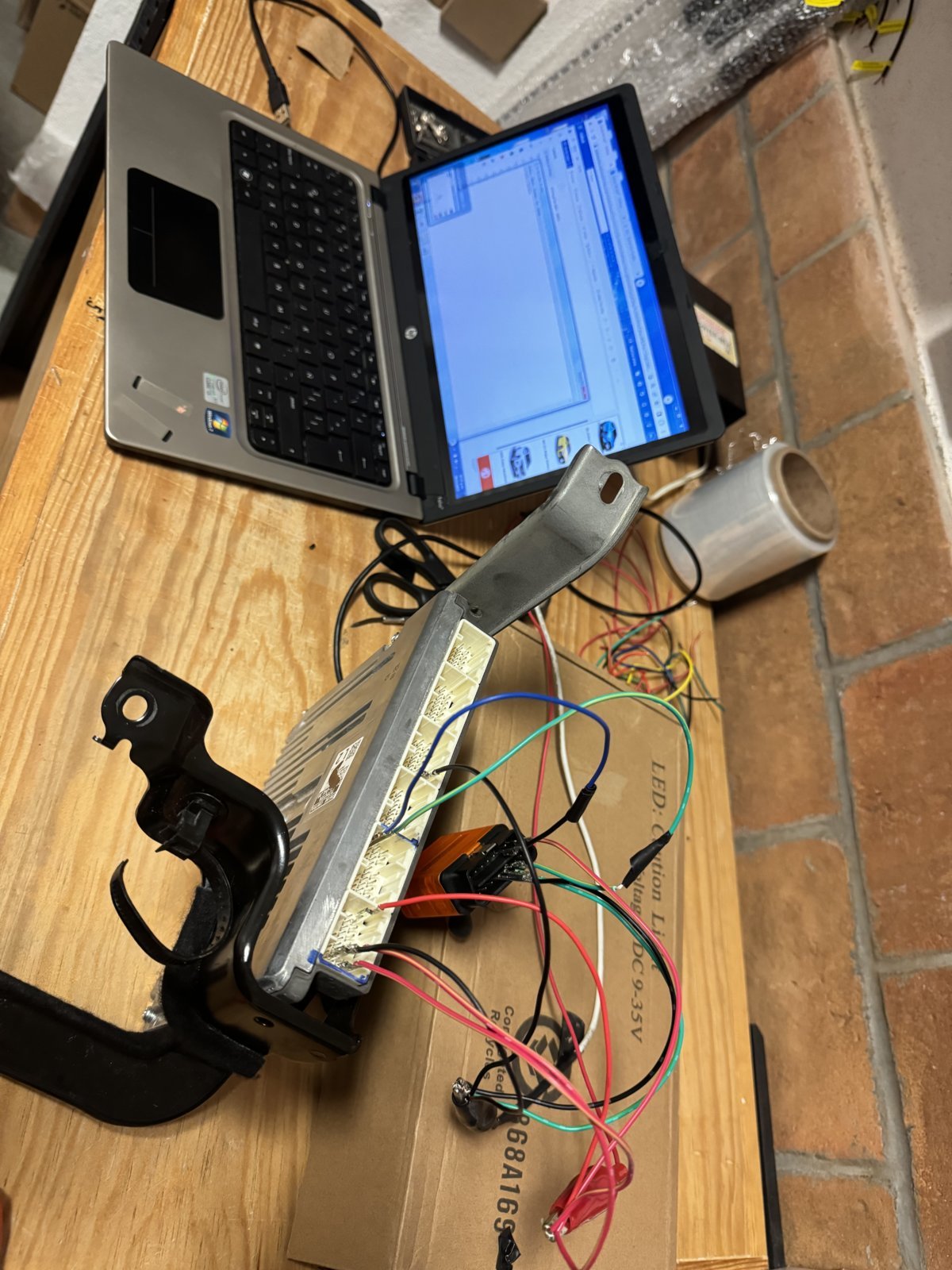

    Updating, Matt sent me a connection diagram, I removed the ecu and I did it, very very rustic, but it worked!! I reinstalled the ECU, the truck started, I turned it off, I flashed it again and everything went well.

    So happy that worked for you!!! I just got my vin flashed to the new ECU with Techstream. It kept failing in VFtuner. I have some stuff coming this weekend and I’m going to try and build that harness to recovery my original. Not messing with my working ecu until I have a backup lol.

    I would like some better pic’s and understanding of how a proper harness should be made.

    Same. I’m surprised somebody hasn’t built one all fancy and started selling them. Shit I’d buy one lol.
