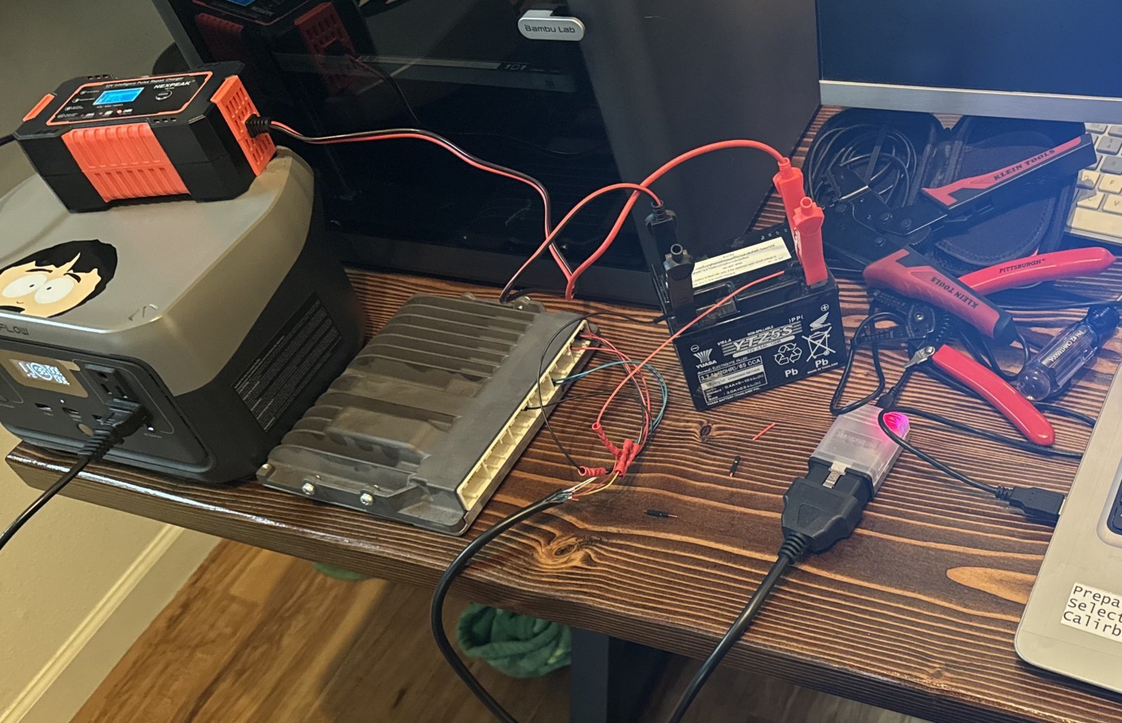

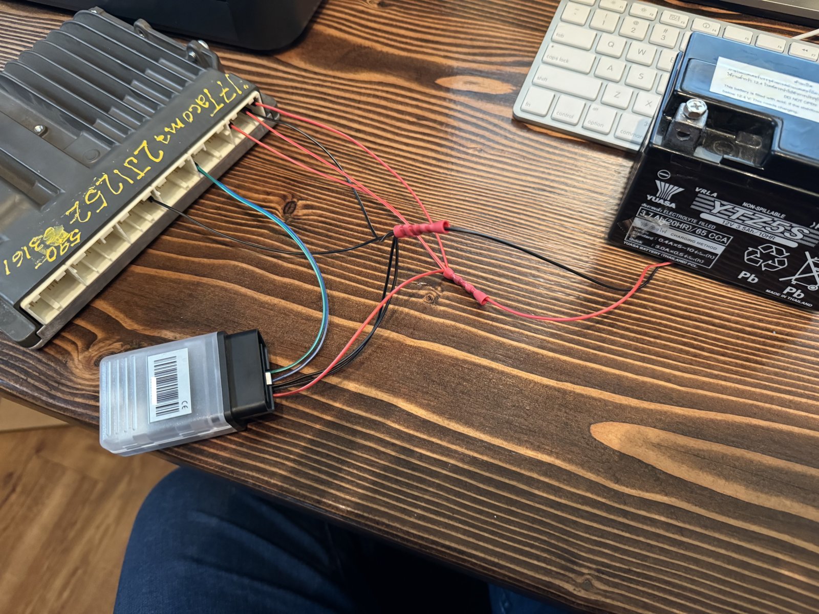

  3. Dec 3, 2023 at 3:27 PM
    #143
    Technique
    Technique Well-Known Member
    Nov 4, 2017
    #235046
    2,924
    Alex
    Utah
    2017 Silver Offroad DCSB
    -285/70/17 Toyo AT3 -Tuned
    It's not pretty, but here is what I ended up doing. It's not hooked up properly to anything besides my ECU in this pic, but you get the idea.
    And these are the cables I used.
    https://www.amazon.com/dp/B01EV70C78?ref=ppx_yo2ov_dt_b_product_details&th=1
    This is my first harness I tried, using an OBDI adapter I got on Amazon. It wasn't working. Traced the cables with my multimeter to ensure I had them correct, but it kept telling me Cable not detected: Vehicle Detected. So I tossed that thing out and wired it directly as shown in my first pic.
