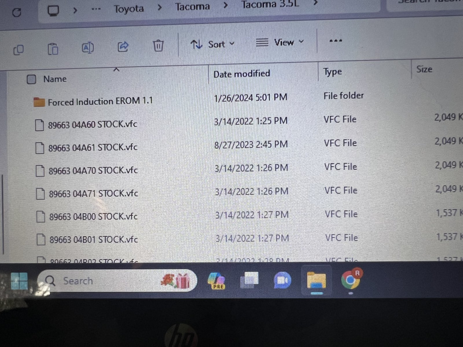

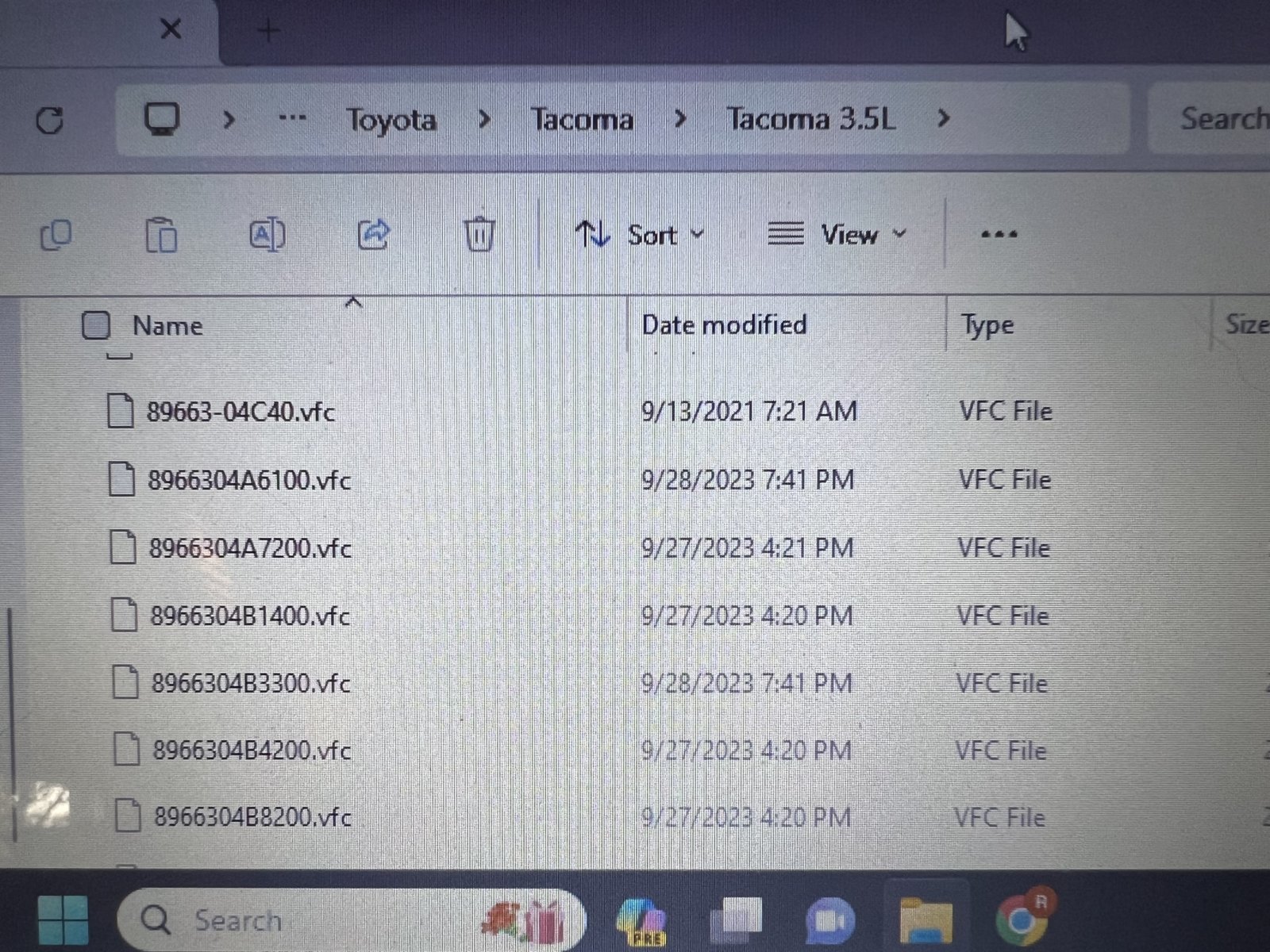

    #320942
    684
    Rich
    Atlanta, GA
    19 Cement Offroad
    MCB Elite Performance Tuned 5.29 Differential Gearing 35" Kenda M/T on Steelies SOS Bumpers, Skids, and Sliders Ranch Camper Shell
    I just did a fresh uninstall, download from his website, and then reinstall, and this is what I get in the folder still…
  10. Jan 26, 2024 at 2:29 PM
    #170
    JustDSM
    JustDSM Oderint Dum Metuant
    Jan 16, 2015
    #146525
    3,308
    Justin
    Ogden, UT
    The 9/28/23 A61 file that's in there is a good version w/ the correct CVN. DO NOT USE the 8/27/23 file.
    My files came direct from Mat so they may be slightly different (date wise) than what gets published in the VFT folder.
