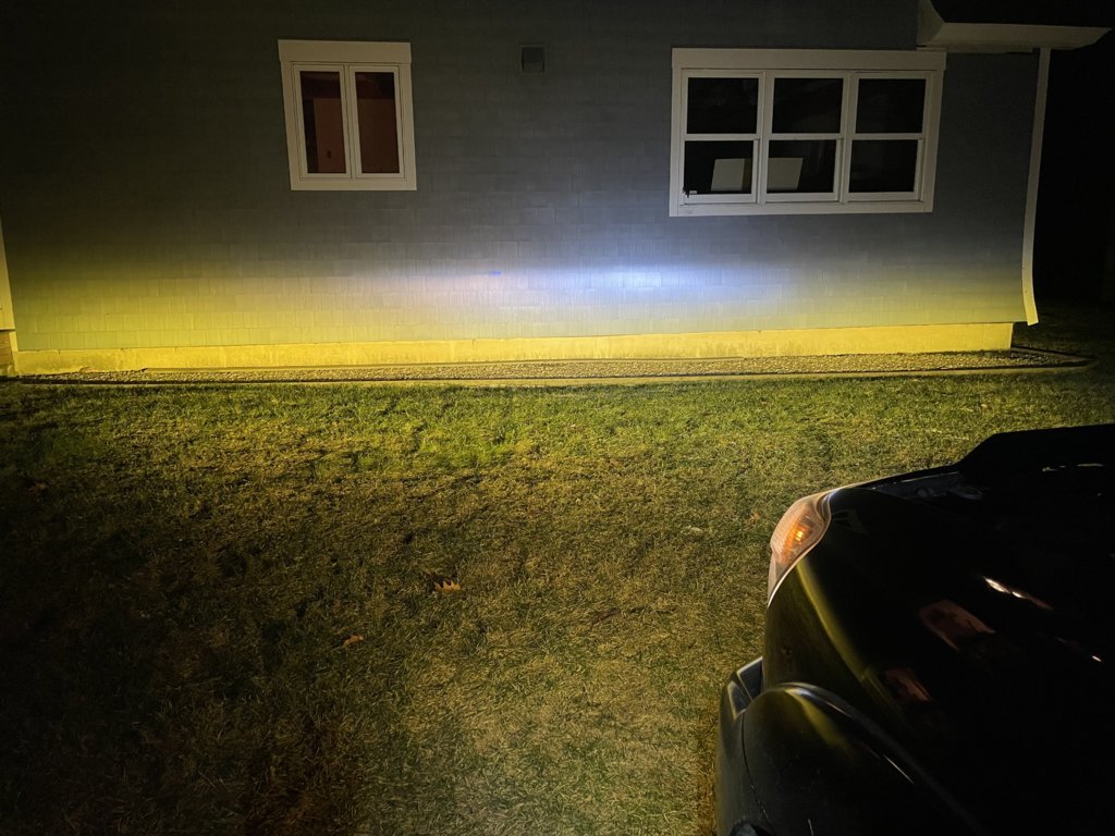

    Stirring the pot since I know everyone on here hates LED in halogen housings, for good reason when they scatter light poorly and blind others. However, I found these LEDs on Amazon last year (ordered and tried a few since they're so easy to swap) and found they had surprisingly had exceptionally good cutoff with just a tad of uplighting just like the OEMs. Photo for reference, OEM halogen on left new LED on right.
    Had to drop the LED just a tad to maintain the height, and yes I dropped my SS3 fogs after this photo which was right after install. The LEDs have been going strong a year now no complaints, high beam projects correctly as well. No clue on actual lumen output but they do feel slightly brighter, I got them mostly for the whiter light. The fogs did the most for me performance wise by far since they light up the sides so well and cut through fog/rain/snow/better. Fog light anytime mod as well helps with high beams on.
    https://www.amazon.com/gp/product/B097BWYYLC?ie=UTF8&th=1
    Rob MacRuger likes this.
