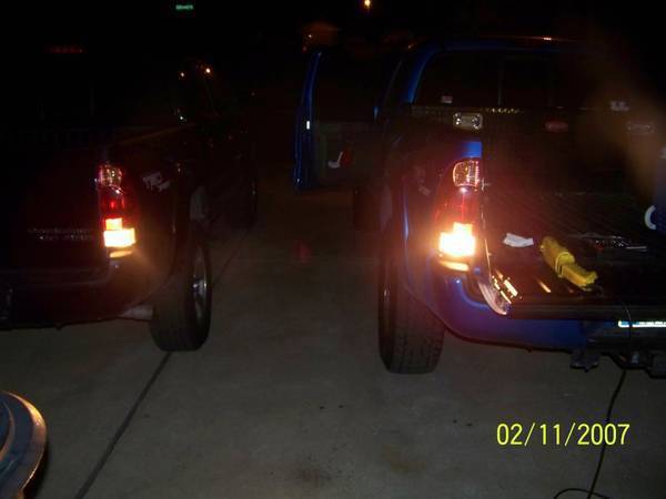

    If you get 886 fog light bulbs from autozone or wherever and use a dremel to cut off the end to where you just have the two wires showing, that will give out more light. It takes about 20 mins to do them both.

    yeah they're in my pics.
    My truck on the right has the new backup bulbs and the truck on the left doesn't.
