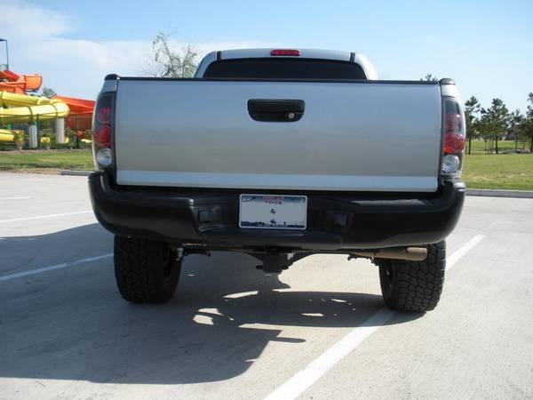

    I have these tails & put silverstar bulbs in the reverse lights. Much brighter than oem. It's like going from having none to having some good ones without adding aux lights to the rear of the truck. Still would do that if I towed much & needed to back up at night tho..........
