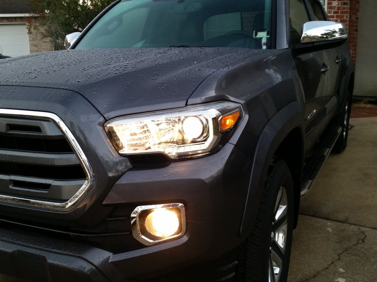

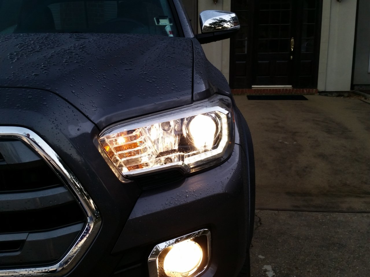

    It's been cool and drizzly here all day. Not dark yet, but I was concerned that trying to take a picture of the illuminated headlights in darkness would just cause everything to wash out. So I went ahead and took these two pics now. In "real life" comparing the whiteness of the stock fog lamps to the Philips XtremeVision low beams, the Philips appear whiter. Recognizing the fact that the DRL's operate in a dimmed mode when the headlights are on, I can say that when I am driving toward a reflective surface (like glass) I don't notice much difference in color between the low beams and the DRL's.

    Are your photos shot on manual exposure with raw images and the raw files processed with identical settings or are you shooting auto exposed, auto white balanced jpegs. Unfortunately, these pictures, like virtually all photos posted on this forum of lights and lighting, are fairly meaningless. And of top of that, the LEDs in the DRLs will probably have huge gaps in their color spectrum making them unpredictable at best when shooting them or the light they produce.

    No, no, no, no, and no. The photos were taken with my cellphone, not with professional equipment. That's why I also tried to describe what I see when looking at the headlights compared to the foglights when they're on, and in a reflection off a window glass at night. Take it for what it's worth, which may be nothing. But to my eyes these bulbs are whiter than the OEM bulbs, and seem to provide better light when driving.
