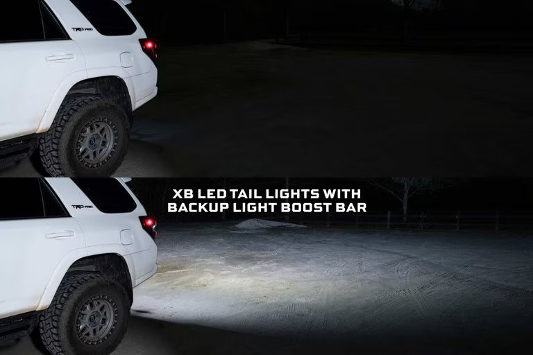

    I have the MESO total tail stage 1 and love the backup light output. They are LED and I have parked the truck and kept it in reverse to keep the lights on for a while without any heat issues.

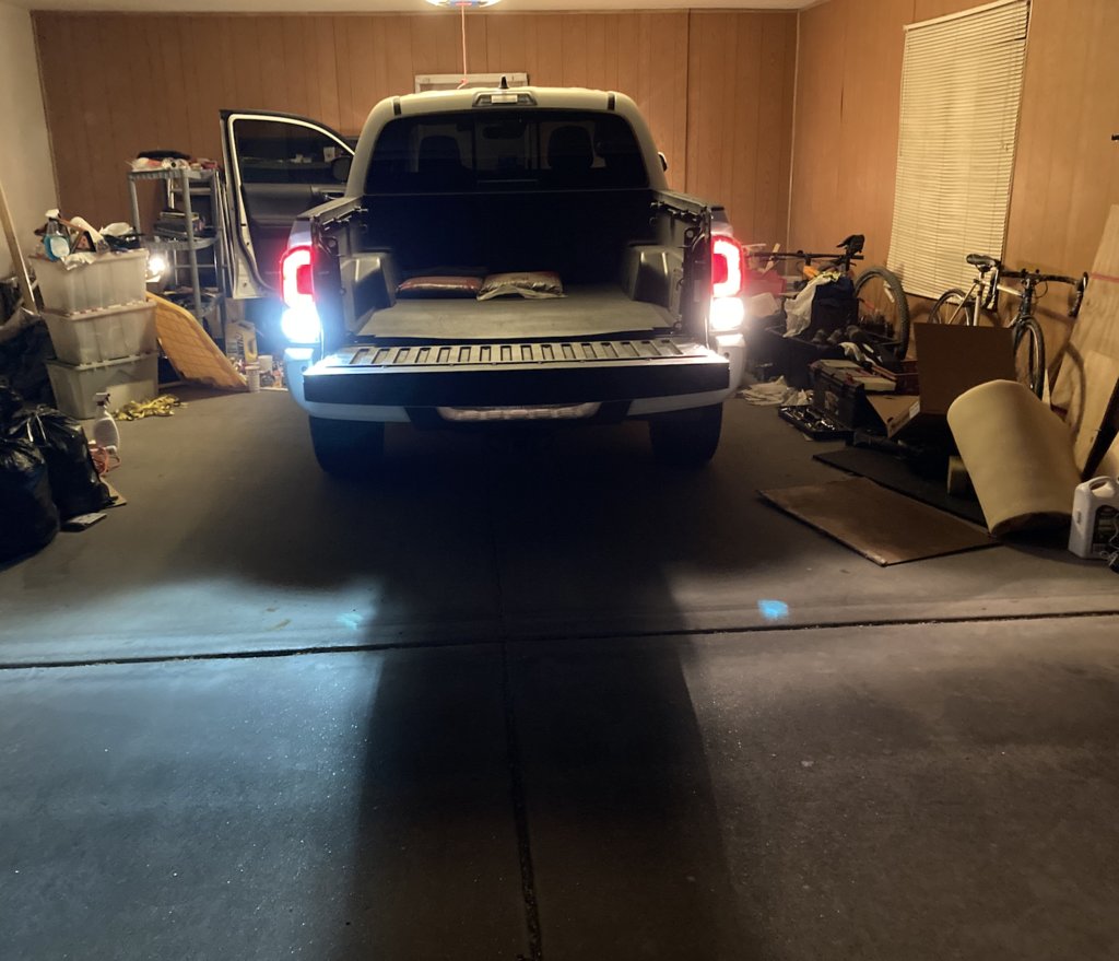

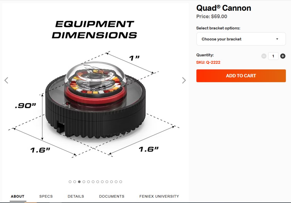

    Since the bulb is the same size as a second gen for the reverse light (from what I just saw online) I thought I'd share this. This fit perfectly in the housing by drilling out the notches that hold in the reverse light's twist in socket. I have the old two color version. Mine came with three triggers. One I wired to my reverse wire, one to a separate strobe controller, and I always planned to have the third to a standalone switch in my bed but never got around to wiring it up. Backup is white only, strobes are white/yellow. If you watch this short vid on my thread you can get an idea of the brightness when the rear of the truck is visible. https://www.tacomaworld.com/threads...adventures-thread.553569/page-3#post-20222239
    EDIT: Did a little digging, and sounds like the older version, like what I have most likely was 180 lumens per white LED. Only 6 would steady burn at a time (mine were 6 white & 6 amber) so max output was 1080 lumens per Cannon. Looks like new has six of each of the 4 colors, so I'm betting it's similar, running 6 at a time.
