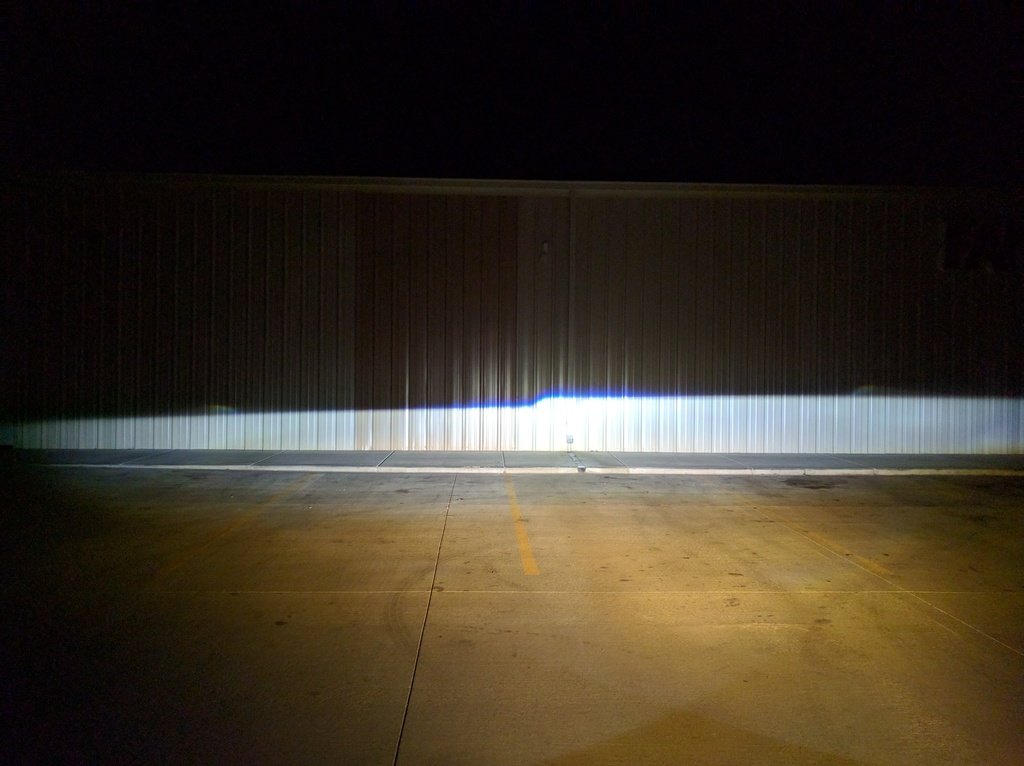

    No... you don't have to spend that much to make retrofits. You could spend as little as $63 for an 'okay' projector upgrade... or maybe a couple Jackson's more for a 'decent' setup... or you could spend $300 for a GREAT projector upgrade... and quite honestly, the only way you're going to spend anywhere close to $700 is if you put a bunch of RGB bluetooth wifi super america iphone halos, LEDs, and custom lens etchings done, all of which have no place in this thread or IMO on any car anywhere. :p
    Also, the Mini H1 is a completely reversible setup. You could go right back to stock halogen lameness at any time. FWIW the Mini H1 has come a LONG way... and even the old ones I used to rock in my truck blew everything else out of the water (high watt halogen, plugnplay HIDs, LEDs, etc). The width is easily 50% more than anything the stock reflectors can provide.
    I honestly have a feeling that (longevity of bulbs and ballasts aside), the cheapest projector upgrade components that I linked on the previous page would still easily beat anything that isn't also HID and in a projector.
