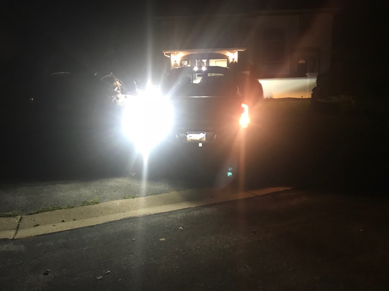

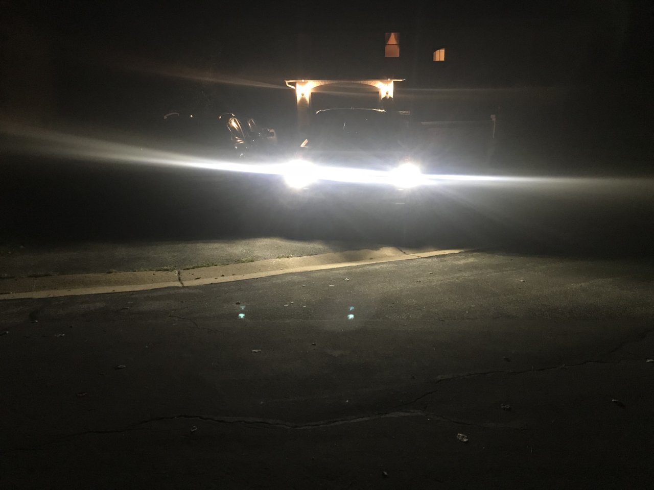

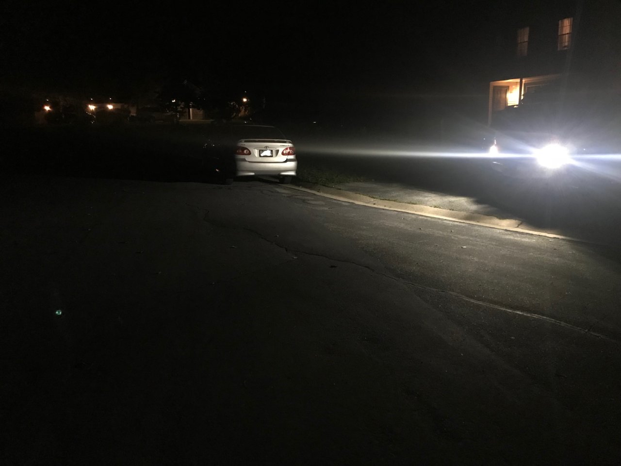

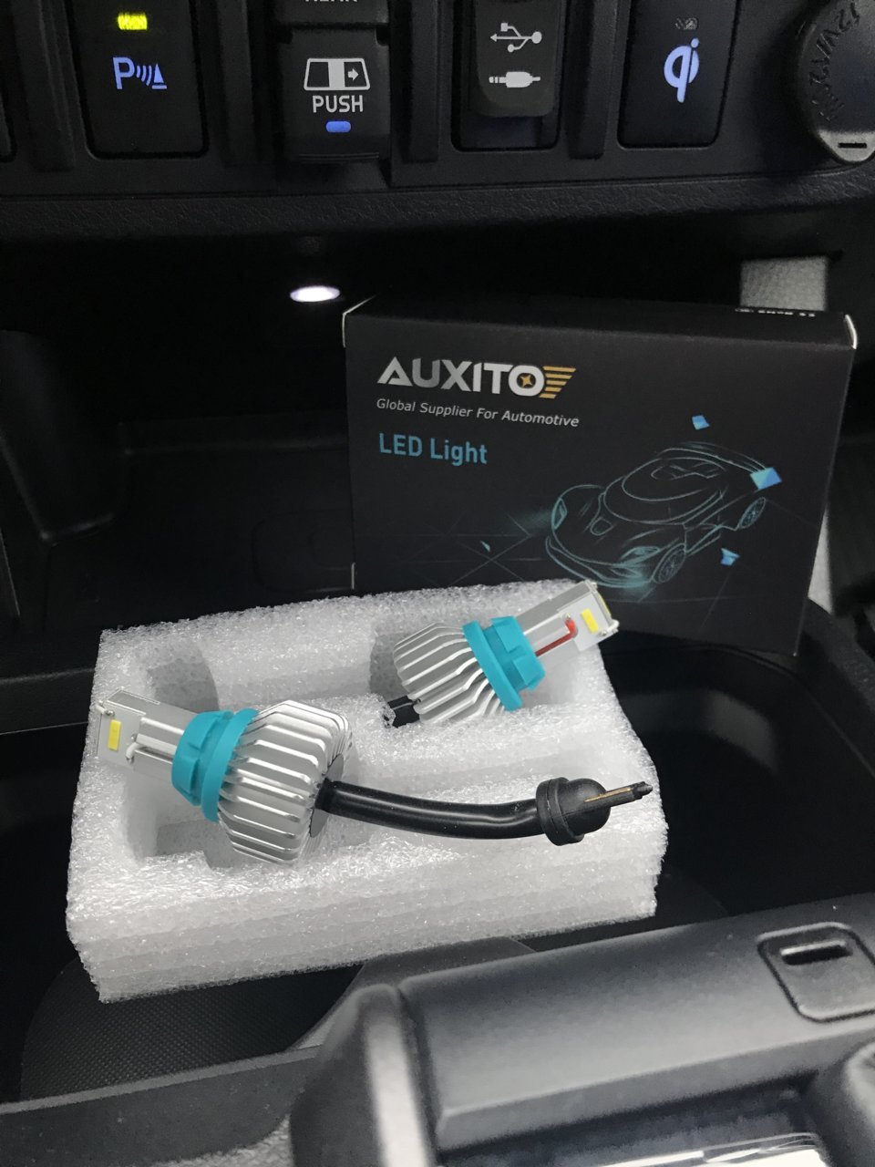

    I have used many different bulbs sold out in the market today for reverse light bulbs and I found these LED bulbs to have the brightest out put for sure.I installed these on my gen3, they are the same bulbs for the gen2 tacomas. I do not have a light lumen tester or anything I am simply stating these bulbs are noticeable brighter compared to all the other bulbs I have used. Hope to help those looking for a bright reverse light bulb set up. Plug and play so easy install.
    I found the best price to be on ebay - AUXITO LED Reverse Backup Light 921 Bulbs ...$29 or so, there are many different sellers of these bulbs on both ebay and Amazon
    Specs
    2000 LM per bulb - 4000 LM total
    color: HID white (6000k)
    Canbus - Plug and play
    GEN 3 Posting
    https://www.tacomaworld.com/threads/brightest-led-reverse-light-bulb.568331/
    Installed
    LED vs Stock

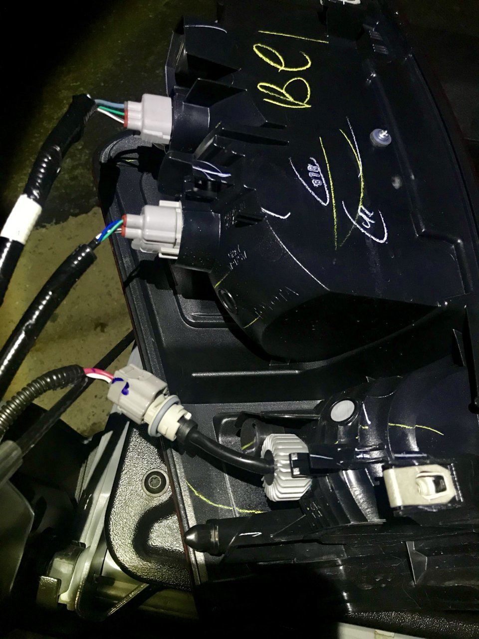

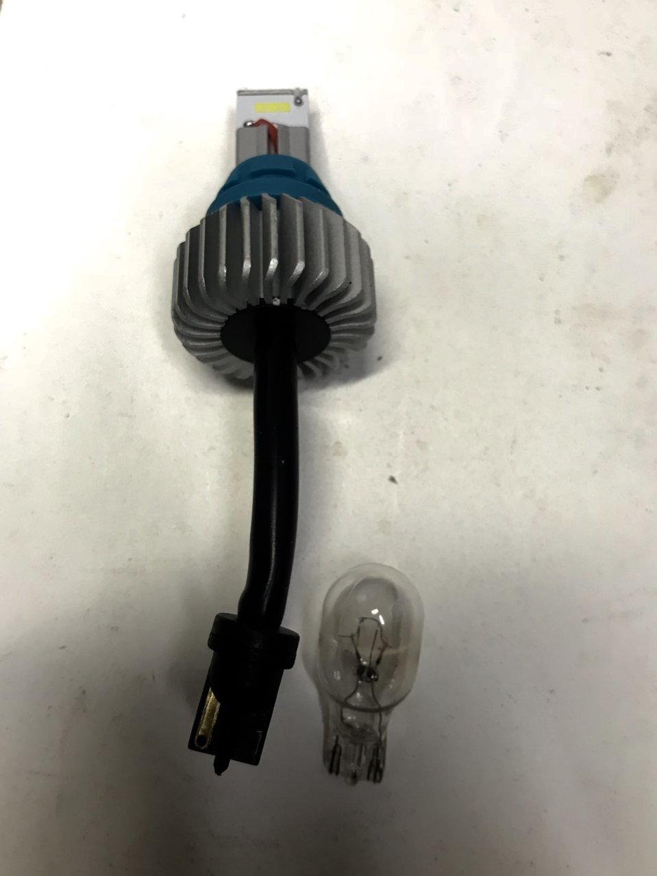

    Plug and play bulb, no splicing or any additional modification to install these bulbs properly.
    Below are photos of the LED unit compared to stock bulb. Both bulbs are the same at the connection point. Also photo of the LED installed into the taillight.
    The baby blue color seating of the LED feels like it is made of a rubber/silicon material. You simply push and give a slight twist of the LED inward of the taillight housing. The LED unit does not lock in like the factory connector, but it is held in very securely that there is no way of it falling out if installed properly. Very straight forward install.

    Be careful not to confuse "brighter" with "more useful light on the ground." Although the photos do appear to show "brighter" reverse lights, remember that the camera does funny things with lights when it's dark out. Many bulbs that appear "brighter" are just blowing more light out where it's not needed. As for the stated output, one also has to be cautious around those numbers. Many manufacturers use theoretical output as opposed to measured / actual output and actual output is always less. 2000 Lumens is guaranteed to be a theoretical number.

    That style LED reverse light is very bright, the same one is sold by various manufactures under a few slightly different permutations. However, more reputable sellers will tell you that it is overdriven and intended for very short use only. Extended use will cause the driver to overheat and fail. Many vendors refuse to sell this style product due to the high failure rate, others just warn the consumer.
    https://headlightrevolution.com/gtr-lighting-high-output-1-000-lumen-led-reverse-bulbs-t15/
    While that eBay seller may spec 2000 raw lumens, output is about 1000 actual lumens. However LEDs drop in output as they get hot, and that design gets so hot so quickly the product fails, so that 1000 lumens likely drops off rather quickly.
    If you’ve ever had to back out of a narrow trail, this can mean being in reverse for very long extended times. Those lights would overheat and fail. I run 860 lumen HIRs which can stay on all day with no drop in performance or product failure.

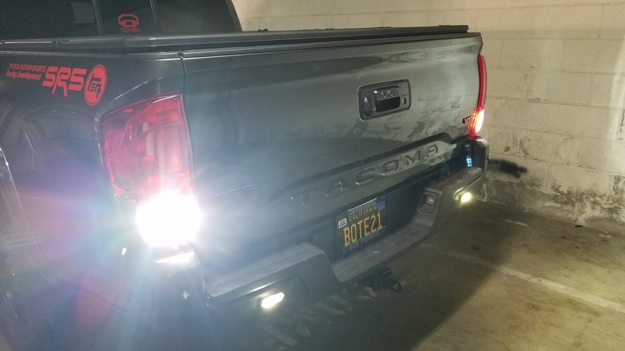

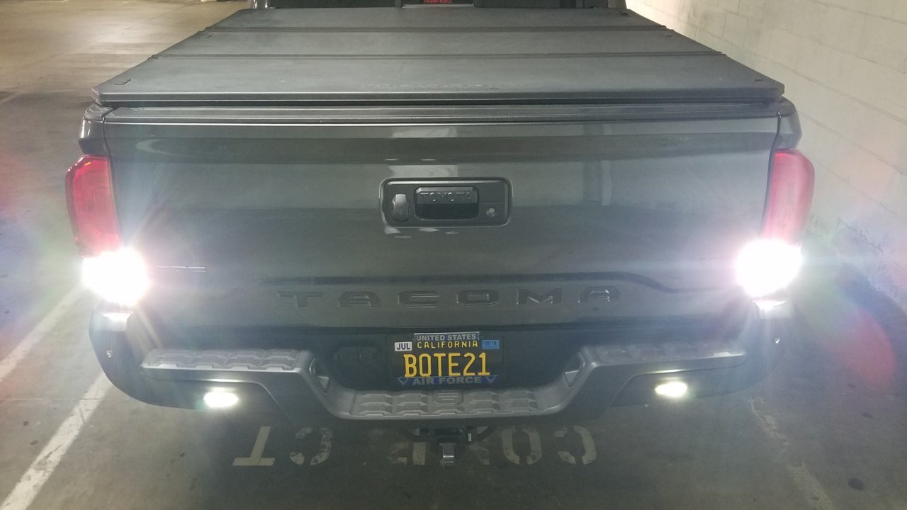

    Never pay attention about the heat it produce coz i never use it for illumination for a period of time... its a revesre light so no worries for me... bottom line is way brighter that stock bulb..

    Nice Bote, I had the flush mount LED in my gen2 rear bumper but I have not done that mod to my gen3 yet. Which Light pod did you go with?
