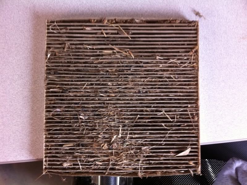

    My bad! My mind flashed to this. The guy ended up with mouse turds in his cabin air filter.
