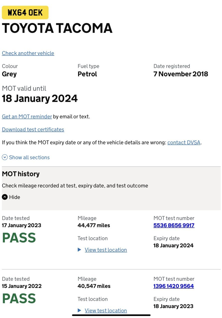

    I shipped my 2015 Tacoma from Colorado to the UK. I’m a Brit with no special US Gov privileges. This was in 2018.
    As a Brit, to avoid tax implications I had to prove I owned the truck for a year before I imported, and that I would continue to use it for my own personal use in the UK for a year. Otherwise import duty is due. This is where working for the US Gov may make things differ.
    Making it UK road legal was not difficult. Headlamps were no issue, as they have a flat beam pattern already. Turn signals need to be yellow. Back of a 2nd gen already have yellow bulbs. Front ones were a drop in bulb for the drl lamp that flashes. Also need turn signal on the sides, so mine had to be drilled into the wing mirrors because 2nd gen OR doesn’t already have lamps on the side. There needs to be a rear fog lamp at the back wired into the cab. If I remember right 3rd, gens have red signals on the rear? Not sure how that would be addressed tbh.
    if fitted, bigger tires will make the speedo readout wrong (it can read over true speed, but never under) and it will fail the initial testing. This was my only hiccup. Keep tires stock and swap out once the first certificate is issued, the speedo doesn’t get checked again in subsequent years.
    The Driver Vehicle and Licensing Agency will take your US Title off you during registration. So you need title in hand, not a copy. I had to tape the title to the windshield for the duration of the shipping process.
    truck’s been fine for the last five years, until I busted a front spring this week, hence I’m here looking up part numbers.
    happy to answer more if you’re still thinking about a Tacoma in the UK.
