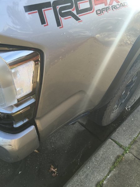

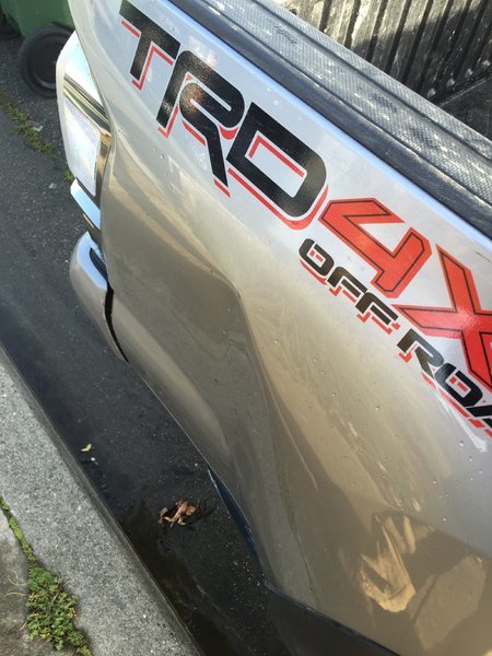

    image.jpg image.jpg Bro you should get some armor for that bad boy. I was out with my bros yesterday broing in a snowy parking lot and I did a massive snow drift into a light poll. Fucked my truck all up. I got home and my pops lost his shit on me. I told him if he didn't want me doing bro shit he shouldn't have bought me the trd off road 4x4. long story short buy some after market bumpers and sliders in case you get stuck on a curb or back into a light poll.
