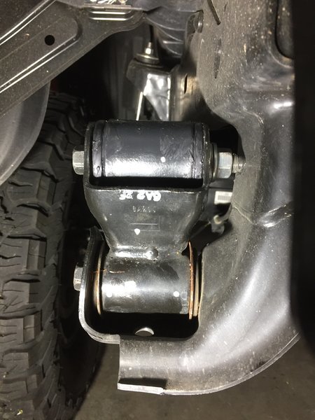

    So, I'm not super stoked about the Dakers. With the 3rd leaf removed, I think I only gained about 1" of lift, and my Taco lean is 1" rear side to side, ridiculous. One good thing is the springs don't negative arch when under load. I took my brothers new 35" Grabbers to Goodyear to get mounted, and the springs barely even noticed the 350-400lbs in the bed.
    I guess ARB marks the springs with - / 0 / + depending on if they are at, below or over spec. Mine were marked with 0.
    I don't want to add the 3rd leaf back in because it's already borderline stiff. But I need to put the 1/2" shim back it so the taco lean isn't as bad. I've gone through like 5 center pins so far bros.
    Dakers on top, factory on bottom.

    They are a pretty flat riding leaf. Good flex tho

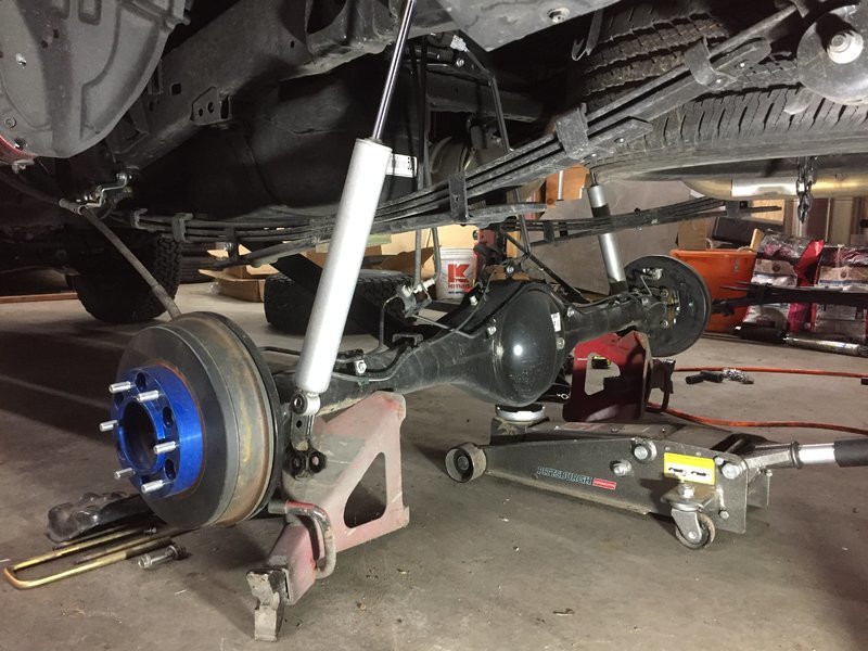

    Alright, Bro-coma is back to where I like to drive it again.
    I swapped the 2" blocks back in. Dakers do a great job of controlling axle wrap. There is less wrap now with the 2" blocks than when she was stock.
    8.75" is pretty beefy.
    Dakers ride pretty flat as @ChadsPride stated.
    Oddly I didn't have any drive line vibrations, but I still added two shims to the carrier bearing. Didn't really notice a difference.
