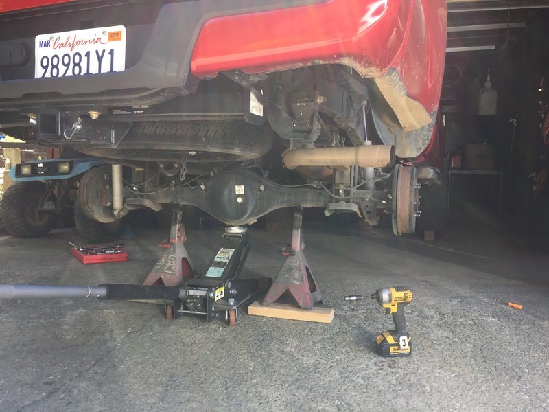

    Operation ARB has begun.
    Tires are off, so it's time now for my union mandated 1hr break.

    Thanks for all the support. The pulling the diff went pretty quick, even with naps in the middle. Roughly 20min worth of work to get to this point. Diff has been dropped of at Rearend Specialties in Santa Clara for the install. They do the absolute best work you're gunna find around.
    I did some of the pre work to save a little time for the Installer, and maybe save a little $$.
    Drilled a 1/4" hole in the Bearing Cap for the Copper Air Line. Came out pretty clean.
    Then drilled a 7/16" hole in the top of the diff, and tapped it to 1/4NPT for the airline fitting, then snugged down the fitting with some thread sealant.
    I also installed the 4" longer Brake Lines from Wheelers. Not really sure how to secure the passenger side line, they didn't come with any instructions or extra clips o_O Might have to do a quick search. Also, I stripped the brake line fittings, they were way to fawking tight, I was even using a 10mm hard line fitting wrench. I had to use visegrips to finally free them.
