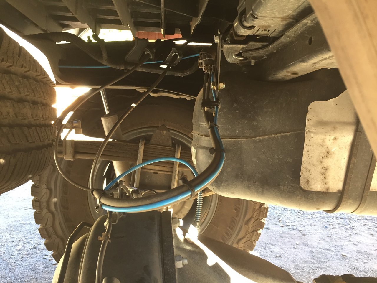

    Side note, I was having issues with the solenoid not engaging for the locker. It was getting voltage but not moving. Turns out it was just stuck. It works perfect now. I did a leak down check and I gave up after 55min. I believe ARB says anything over 15min is a good seal :bananadance:
    Not sure if I ever posted a pic of how I ran the ARB line to the axle. IMG_1728.jpg
