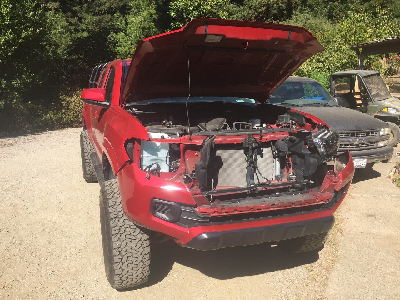

    Let the real mods begin...
    Also got the pass. light under the knife for the BHLM and HID Retrofit. @mesojdm got it right, 295* for 15min and the lense comes off in under a minute. Just make sure your aunt doesn't catch you baking it. There is a pretty good plastic smell at that temp.
